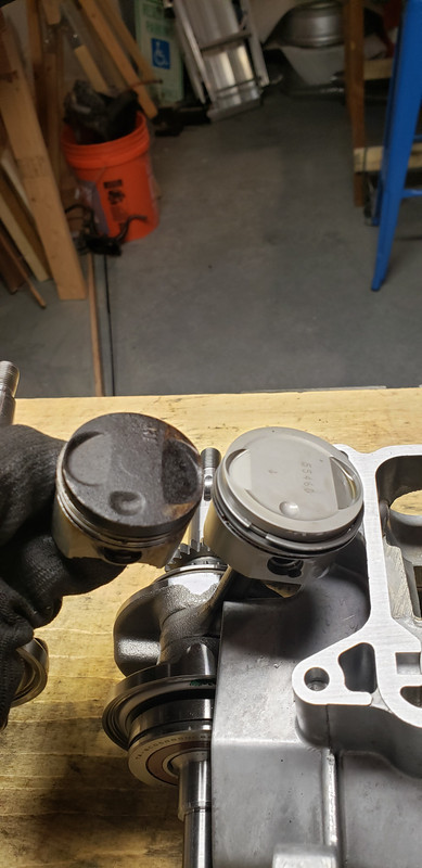

Installed met gears and transmission case on the ruck swingarm I got from Happypancake! Which shock mount do I use? Do I cut the other one off? ![](https://i.postimg.cc/dQj5BXmR/20191130-150415.jpg) More pics from recent tinkering... ![](https://i.postimg.cc/CMcjdVs2/20191130-105029.jpg) ![](https://i.postimg.cc/Qt0WBp17/20191130-105031.jpg) New vs old piston... ![](https://i.postimg.cc/wvf7x9Yc/20191130-103647.jpg)

dankhill- serious question. I forget what you call those indentations in the top of the piston; for each valve. but since the new piston has slightly smaller indents- does that mean more squish? and slightly more compression ? thanks
Post by Happypancake! on Nov 30, 2019 19:40:37 GMT -5
The “dents” are different because the piston is larger. There is actually less quish with that piston so U can still run normal octane. Cheers!
Post by Happypancake! on Nov 30, 2019 19:41:59 GMT -5
Installed met gears and transmission case on the ruck swingarm I got from Happypancake! Which shock mount do I use? Do I cut the other one off? ![](https://i.postimg.cc/dQj5BXmR/20191130-150415.jpg) More pics from recent tinkering... ![](https://i.postimg.cc/CMcjdVs2/20191130-105029.jpg) ![](https://i.postimg.cc/Qt0WBp17/20191130-105031.jpg) New vs old piston... ![](https://i.postimg.cc/wvf7x9Yc/20191130-103647.jpg) It doesn’t matter on the mount. The one that clears the tire and is straight
Post by jloi on Dec 1, 2019 9:43:58 GMT -5
Aaaahh , ok. I wondered if I had the squish "reversed" . thanks... learning

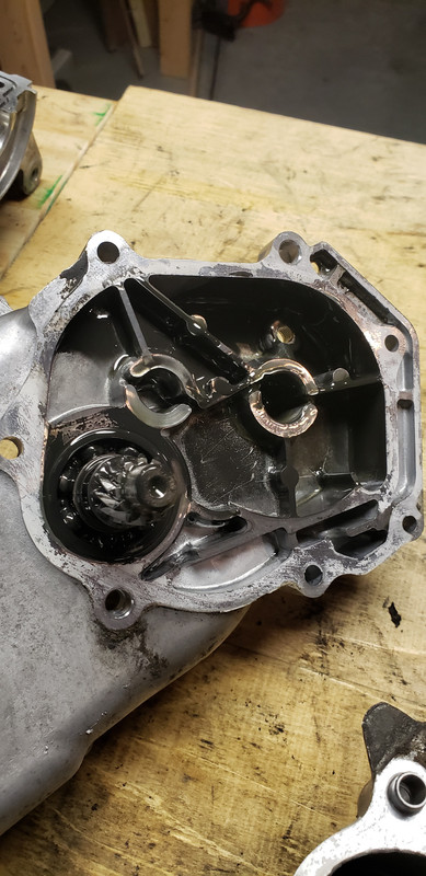

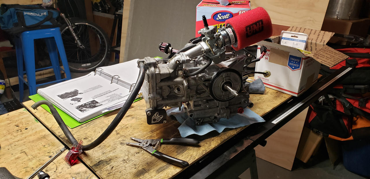

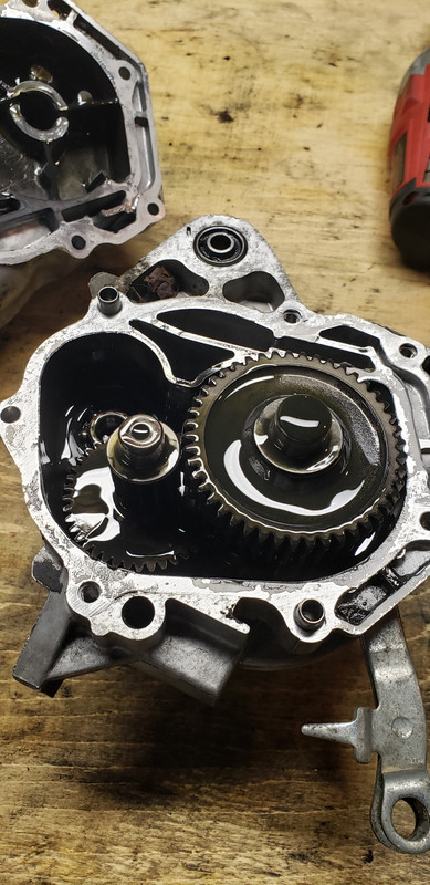

With all parts finally in hand, I did the engine build on Sunday. Everything went in without a hitch... however, the other metro GETting rebuilt with mine had a head bolt snap. Luckily Bob got out extracted in less than 5 minutes with a straight blade screwdriver and some swearing. No harm no foul I guess. I do have one question though: can you install the cam backwards? Or is it fool proof? I think I got everything lined up and timed correctly, but am I or can I be 180° off? ![](https://i.postimg.cc/d3P2ZX4r/20191215-173438.jpg) ![](https://i.postimg.cc/7ZsSnbKx/20191215-173423.jpg) ![](https://i.postimg.cc/43jtjqCq/20191215-173434.jpg)

Post by Happypancake! on Dec 18, 2019 21:01:48 GMT -5
Might want to turn over several times by hand to make sure timing is spot on. Cam can’t go in backward. Nice work.
Post by Happypancake! on Dec 19, 2019 6:20:42 GMT -5
With all parts finally in hand, I did the engine build on Sunday. Everything went in without a hitch... however, the other metro GETting rebuilt with mine had a head bolt snap. Luckily Bob got out extracted in less than 5 minutes with a straight blade screwdriver and some swearing. No harm no foul I guess. I do have one question though: can you install the cam backwards? Or is it fool proof? I think I got everything lined up and timed correctly, but am I or can I be 180° off? ![](https://i.postimg.cc/d3P2ZX4r/20191215-173438.jpg) ![](https://i.postimg.cc/7ZsSnbKx/20191215-173423.jpg) ![](https://i.postimg.cc/43jtjqCq/20191215-173434.jpg) If that is the cast intake manifold, you may wish to support the carb as I have seen several of those intakes crack due to stress and vibration . Cheers
Post by dankhill on Dec 20, 2019 10:14:13 GMT -5
How did you support yours? Any ideas? Or do I just Pollack engineer it?
Thanks for all the help/tips
Post by Happypancake! on Dec 20, 2019 11:17:49 GMT -5
How did you support yours? Any ideas? Or do I just Pollack engineer it? Thanks for all the help/tips Mines a billet intake. Just rig something under it
