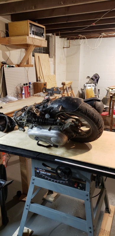

Post by dankhill on Nov 14, 2019 11:53:28 GMT -5
Post by Happypancake! on Nov 14, 2019 20:23:26 GMT -5
That's the older head. You should add the newer crankcase vent/cam chain tensioner. Also, cut the nubbie off the inside of the intake and cap the nipple. Cheers!
