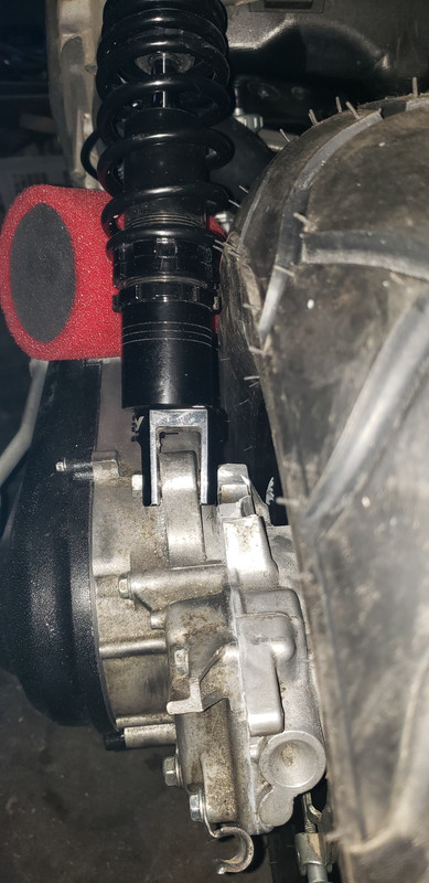

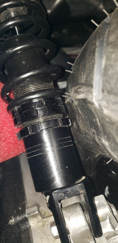

Post by dankhill on Mar 11, 2020 19:56:18 GMT -5
Got the new exhaust today! Thanks Happypancake! ![](https://i.postimg.cc/htJj2yD3/20200311-194714.jpg) Also - here's the shock clearance issue. I ended up cutting the met mount but it's too close to the wheel anyways. ![](https://i.postimg.cc/W1M3RDZM/20200311-185043.jpg) ![](https://i.postimg.cc/Pxn9gxm8/20200311-185015.jpg)
Post by Happypancake! on Mar 12, 2020 11:16:57 GMT -5
Got the new exhaust today! Thanks Happypancake! ![](https://i.postimg.cc/htJj2yD3/20200311-194714.jpg) Also - here's the shock clearance issue. I ended up cutting the met mount but it's too close to the wheel anyways. ![](https://i.postimg.cc/W1M3RDZM/20200311-185043.jpg) ![](https://i.postimg.cc/Pxn9gxm8/20200311-185015.jpg) Spin the bottom mount 180deg
