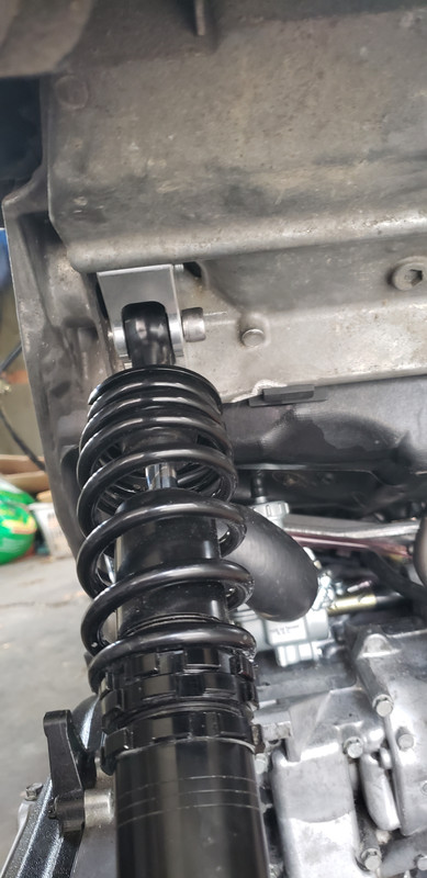

No dice...flipping it didn't improve... it actually was hitting more.
Im thinking of tying a narrower shock... unless I can find a part that shifts the top mount outboard about 1"

Hey Dank, I use the same shock on balls with 1/4 inch gap to tire. How are you mounting the top? Sorry if you already posted it, couldn’t find it.

Hey Dank, I use the same shock on balls with 1/4 inch gap to tire. How are you mounting the top? Sorry if you already posted it, couldn’t find it. Like this. I had the stock clevis on the top end of the sock as well and that didn't quite fit either. ![](https://i.postimg.cc/nrFhfhXn/20200314-150342.jpg)

Im thinking back. I had a similar braket like yours not line up either. I grinded some of the frame and mounted the eyelet on the shock side to side with the one in the frame. Also I have the regular NCY, yours may be the shorty?
Post by dankhill on Mar 14, 2020 21:09:31 GMT -5
That one is a regular one to I think. It's the 245ish mm.
Can you take a pic of your top mount situation?

I may have shifted motor over a bit, teeny bit. I remember cutting something, not the bolt, maybe a sleeve.
Post by dankhill on Mar 16, 2020 8:37:47 GMT -5
To be clear...do I need to shift the engine mount or the shock mount?

Either. Does the stock shock work. If so, put it on and GET it running and tuned. Worry about the shock later
Post by Tanuki on Mar 16, 2020 12:35:13 GMT -5
Shift engine mount only to center the wheel.

Also no stock shock. That little guy busted on me last year.
Post by dankhill on Mar 16, 2020 22:11:32 GMT -5
So stock bolt is 10x230. Should I get 10x245? Those frame bushings are 15mm.
