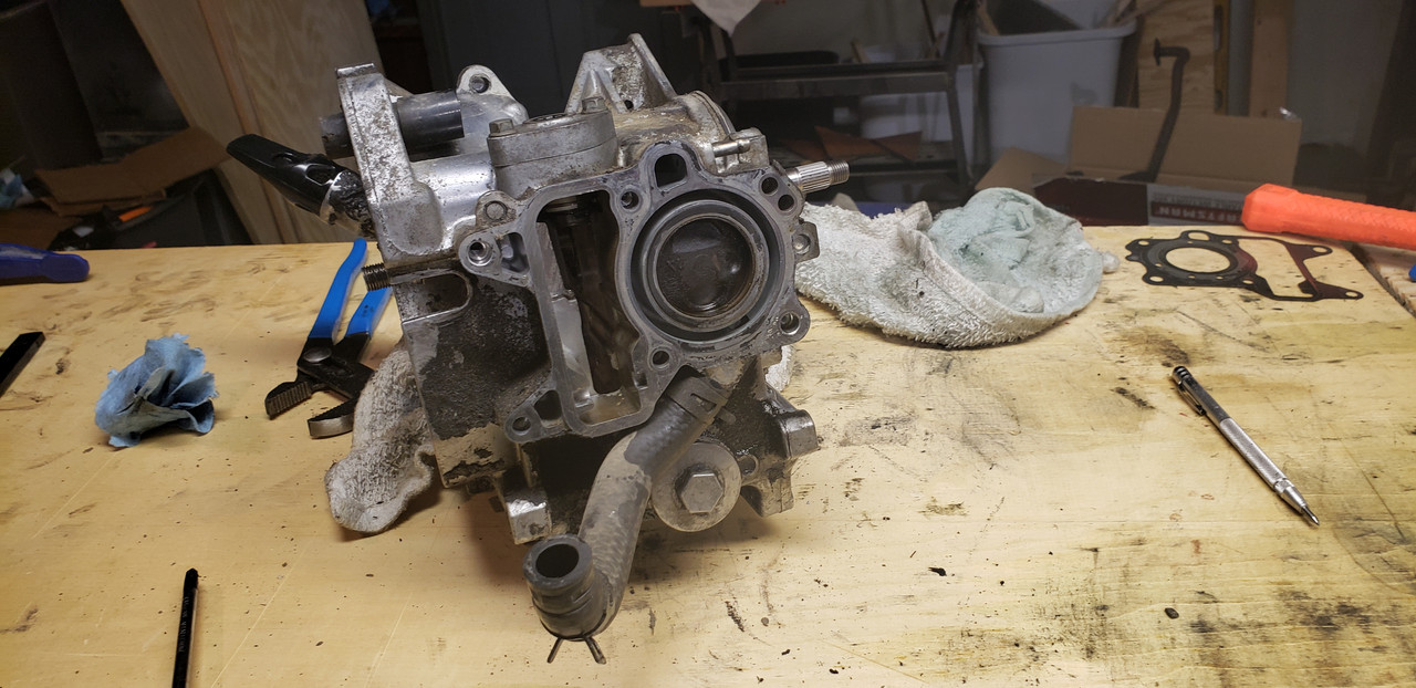

Exhaust valve is definitely hitting the piston. Cylinder wall looks great. Now I'm going to the basement to dig into the valves. Maybe I need a new retainer for the exhaust.

Post by dankhill on Apr 5, 2020 10:36:18 GMT -5
Post by dankhill on Apr 5, 2020 14:11:56 GMT -5
Old valves are in and it's still making noise...
I wonder if the piston was made out of spec. I got a response email after I asked if they were making more before I got this one. I got an email after I had this piston saying something to the effect of 'since some pistons were made out of spec (Wiseco confirmed) another run had been ordered'.
Maybe the wrist is just a bit too high...

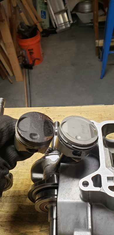

Post by dankhill on Apr 5, 2020 14:45:05 GMT -5
The stock is normal... here it is before and after I took it out ![](https://i.postimg.cc/rFyDBQqJ/20191110-142224.jpg) ![](https://i.postimg.cc/ZRtsWkC6/20191130-103647.jpg)
Post by 190mech on Apr 5, 2020 15:45:09 GMT -5
DUDE!You 4stroke guys gotta know you are dealing with a thousand more parts than us 2strokers and they ALL gotta fit right!!Brent did a lot of work on his failed GY6-150 and as usual documented it all wonderfully..There is a valve to piston clearance issue here due to the piston relief being too shallow during the overlap period with this magic overbore piston..Bernt shows the checks here; 49ccscoot.proboards.com/thread/15714/piston-valve-clearance-info-checksAny time something is changed in a 4stroke,this is a must do process..Sooo many just want to bolt it on and RIDE!!You'll be lucky no valves are bent(usually intake),,The aftermarket folks love it as they can sell more parts..Please follow Brent's vids and you will have no doubts when run time comes.. ![(2cents)](//storage.proboards.com/2855264/images/dhWVBYYMgydFRVbqAQRs.gif)

The stock is normal... here it is before and after I took it out ![](https://i.postimg.cc/rFyDBQqJ/20191110-142224.jpg) ![](https://i.postimg.cc/ZRtsWkC6/20191130-103647.jpg) Is the measurement of the center of the wrist pin to the top of the cylinder the same?
