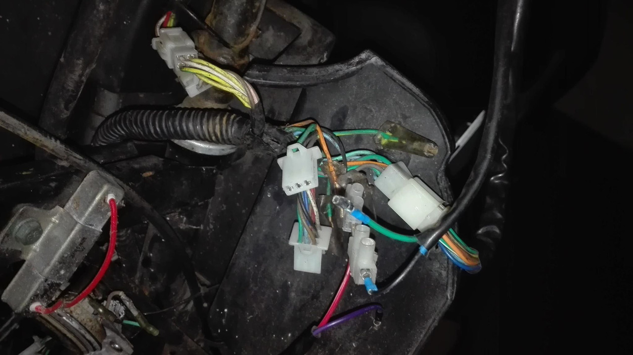

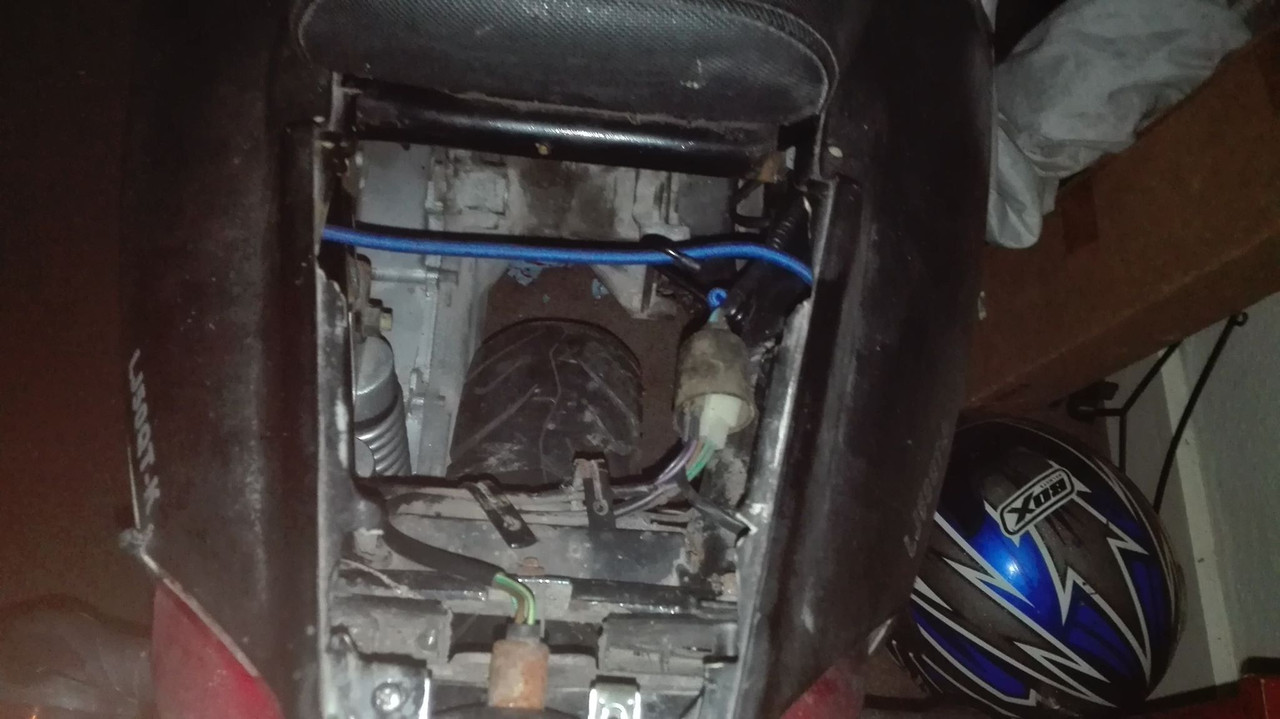

bit of a update fitted stage 6 bearing , top performance crankshaft and dr70 kit , stage 6 intel and reed block , 24mm flat side oko carburettor , leo vince zx exhaust ,top racing 20% primary gear up kit need to fix some of the loom still as blowing fuses a lot this was from when the bike got taken and need to get things readying for painting this weekend and adding my fuel cell under the seat but got to say it pulls very well done around 65 miles since building the engine up 2 days ago but i think at the end of the month i may go for the yasuni c16 as that will be more suitted for when i get a better bbk then the dr70

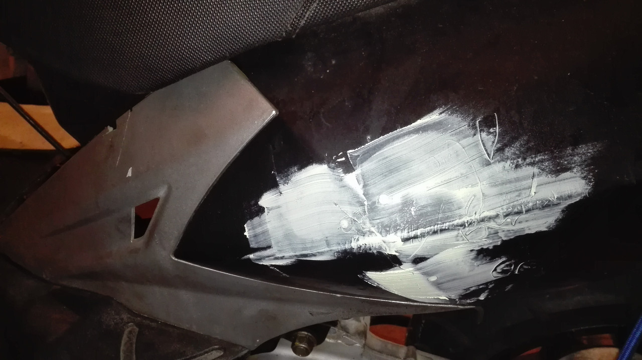

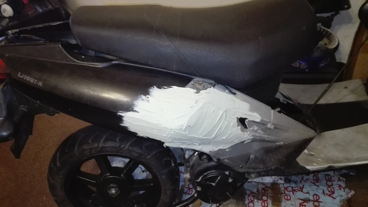

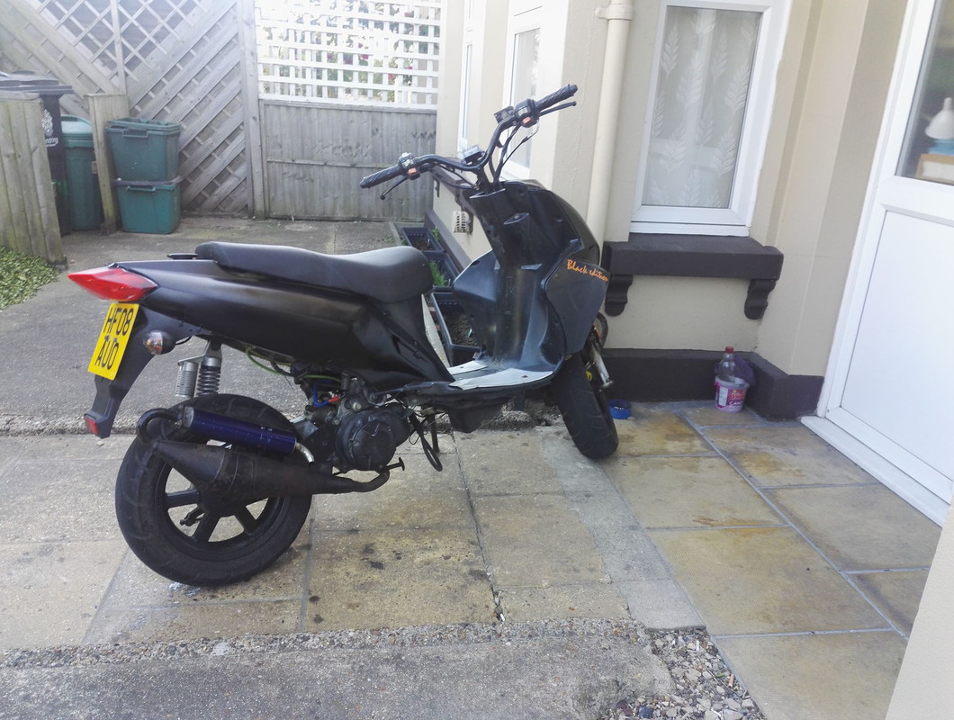

Post by mrchilled85 on Apr 10, 2020 3:17:28 GMT -5
with lockdown in place i have been a bit limited to just what i can do so started on the body work one side is done now before after just waiting on more paint now that will be here hopefully today or tomorrow so i can get the rest of the bike done

Post by mrchilled85 on Apr 10, 2020 17:00:01 GMT -5
When I was in college I was fixing fairings as a side income. Now I am too lazy to fix my own fairings. Good job! thanks the other side is neary all done now thank god as that had a 5inch hole in so had to rebuild neary half the panel

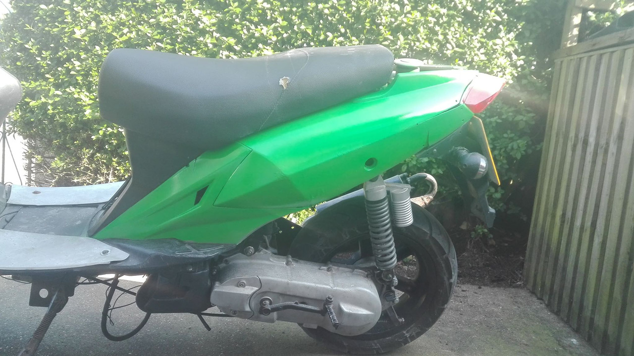

Post by mrchilled85 on May 13, 2020 15:29:09 GMT -5
dont know if i like the green more then the black now after giving the other side a layer of black not to much done to the bike the last week just been trying to sort out the fueling as not running that great

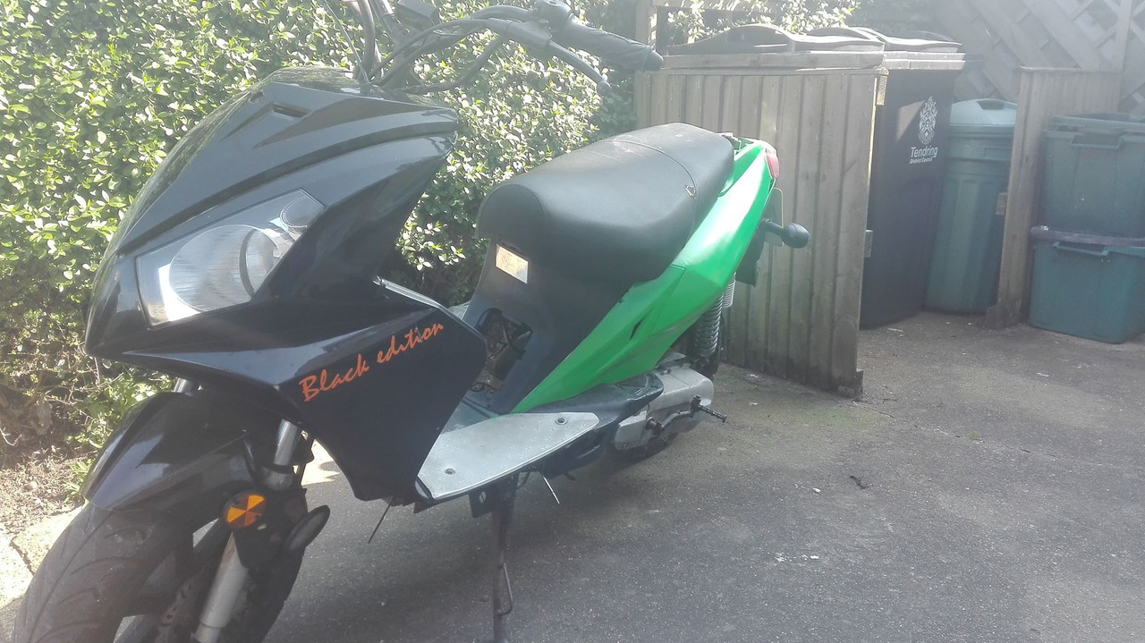

Post by mrchilled85 on May 16, 2020 3:00:15 GMT -5

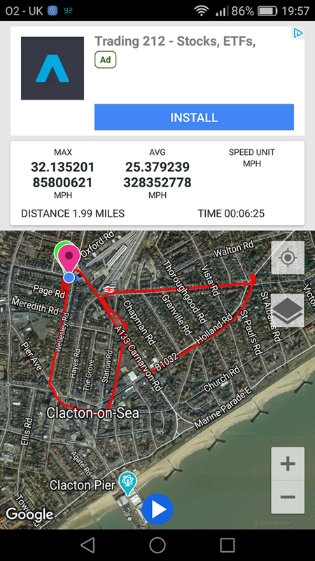

bit of a update i picked not to go full green ended up going back to black the new belly pan will be here next week as well all ready in black to been trying to get the bike running 100% but getting a fair bit of white smoke from the exhaust when im running flat out and only hitting 32mph if im lucky at time as can be seen in this video and gps map i was thinking over jetted for the porting i have done but if i drop any smaller in jet i just cant build up the rpm over 6000 rpm changed the crankshaft seals and checked for air leaks cant find any and fitted new gasket set , reed block and inlet gasket to so im at a bit of a lose right now what can be doing it tryed changeing the stock 6gm rollers down to 5.4gm and then down to 5gm still getting the the same i was thinking maybe the belt is not the right size but i will check that later on as just got home from a nightshift

just seems so slow still tho as at a push only getting to 32mph i know its a very stock bike apart from some port work its been so long since i had been on a stock bike dont know if its just me or not

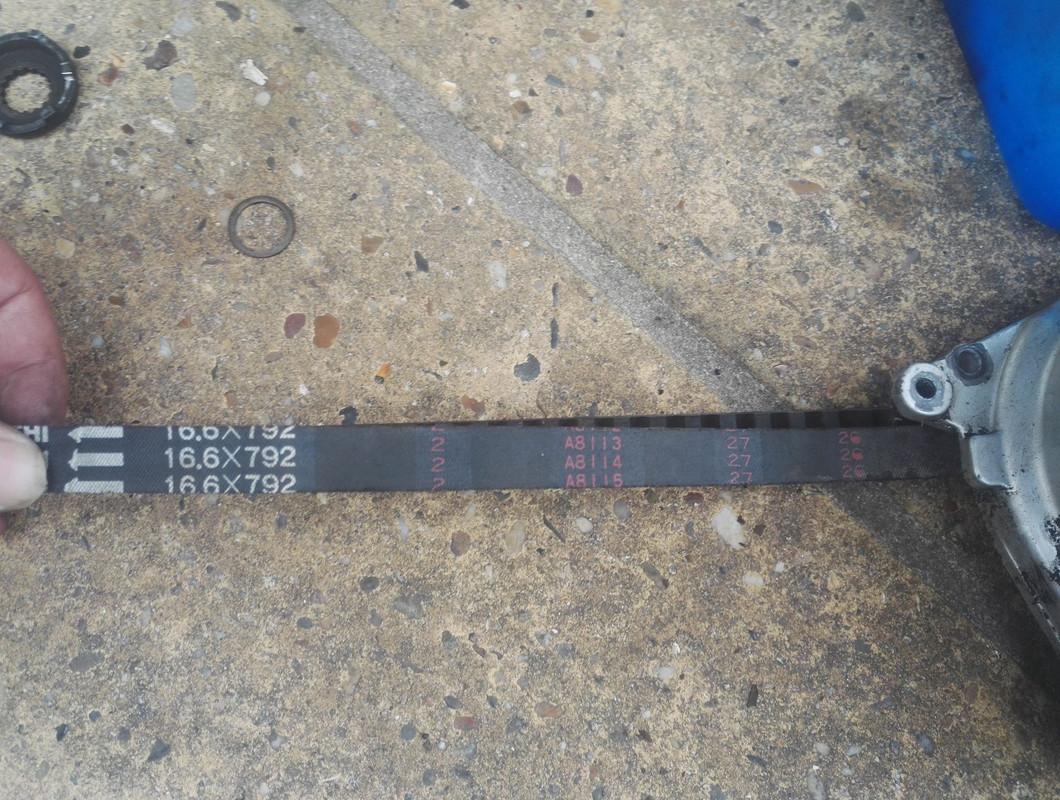

Post by mrchilled85 on May 16, 2020 14:41:03 GMT -5
well seen something im not to happy about and shame i did not see it when i fitted the belt 3 weeks ago with out checking it :/ they did not send me the right one they sent a 16.6x792 and as you can see it dont get upto the top of the clutch so i tryed one of my old belts to check the size and 788 17 28 its great and gives it a lot better bottom end and gets right up to the top of the clutch have asked my friend if he still has the old hebo performer exhaust i lent him 3 years ago or not as that was off a aerox so will fit right on
