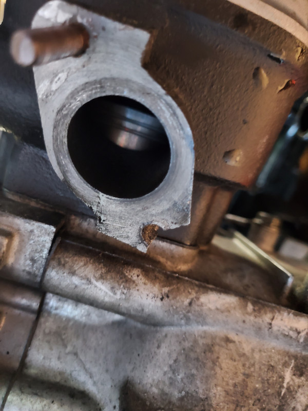

Ill start with the bad news. I was doing some heat cycles on the new Stage6 Streetrace cylinder with the radiator hooked up temporarily in the new unfinished cowling. The exhaust flange cracked around one of the studs during the very first break-in ride. Stage6 is unwilling to replace it and ScooterTuning understandably wont take a return on the item. Thankfully they offered me a site credit to use in replacement which is good enough for me. As a replacement I ordered up a Polini Corsa and a Top Preformance PGO Race Crank to handle the horsepower. I may do some porting on the Corsa but I am not sure. If anybody has any pointers on porting I would really like to hear them. I have been reading this blog and have found it really useful.

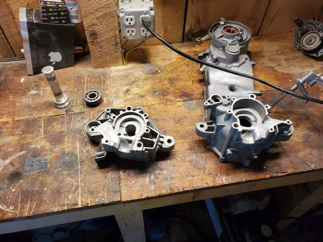

Today I broke down the engine cases completely. I used a Tusk brand case splitter and couldnt be happier with the results. Made a very scary PING when the cases separated but that was just the crank being freed of its bearing.

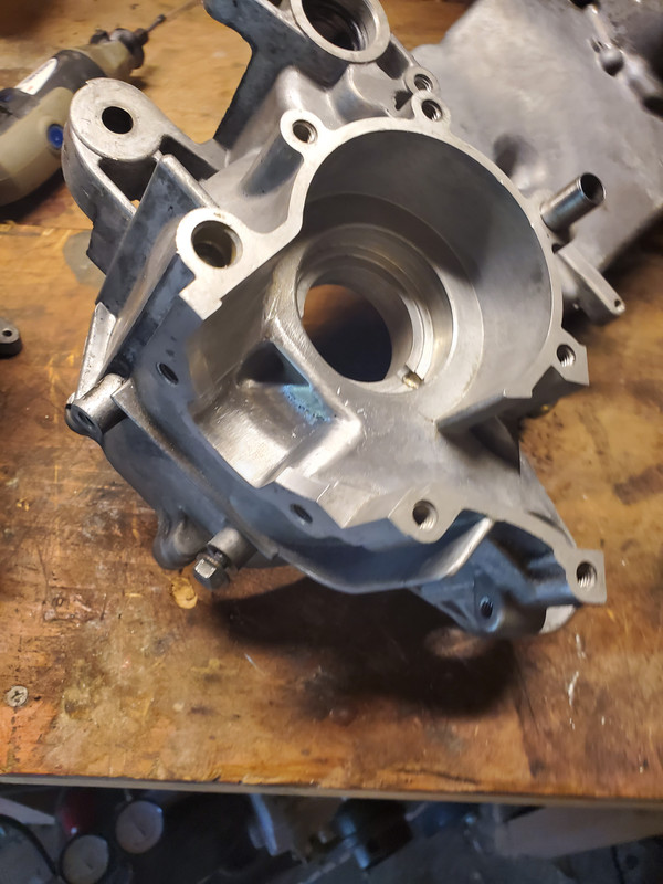

I also got around to flowing the case halfs. I did not want to go crazy so I just used some small files and a rotary cutter on a very low speed. I also used some different abrasive paper to blend the surface. Here are some pics, let me know how I did!

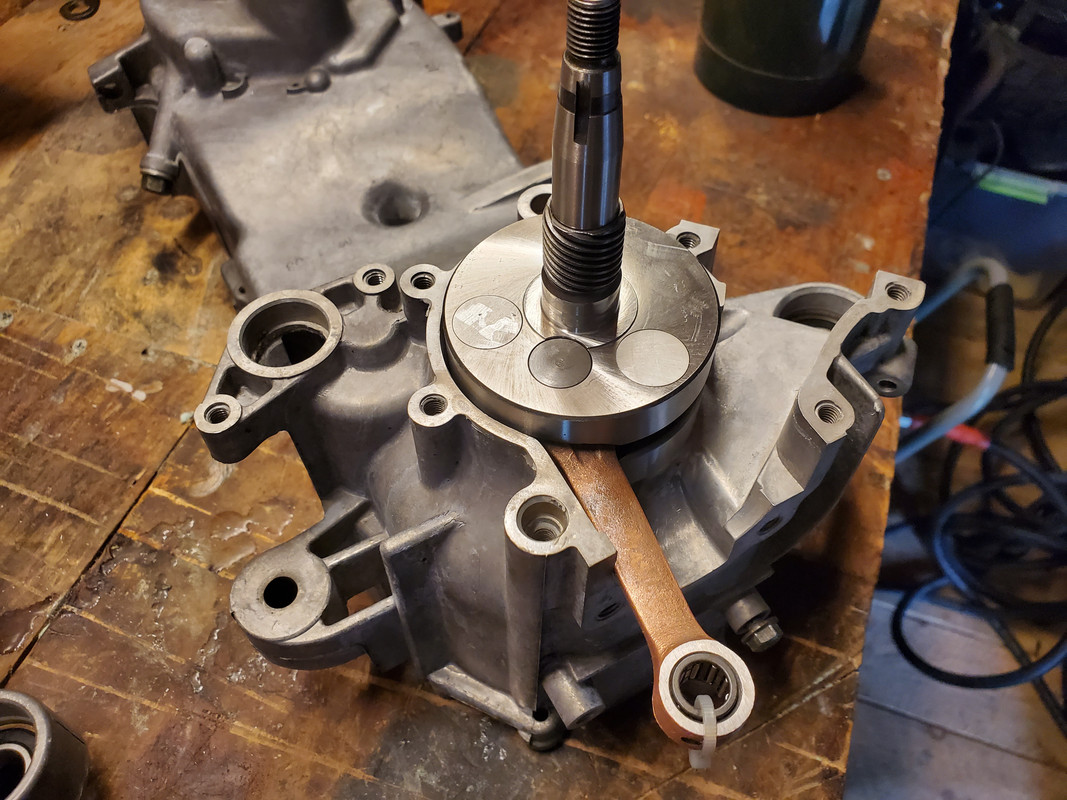

I got a bunch of parts in from ScooterLounge and Racing Planet including the crank and bearings. I stripped the cases down for degreasing and more cleaning. I used the heat method to install the bearings onto the crank however no matter what I did the crank wouldnt install into the cases straight. I ended up using a bearing splitter and a two arm puller to take the bearings off the crank. I used a race installer and a torch to seat the bearings into the cases. Using the same heat method I installed the crank into the large case half and applied the Hondabond around the sealing areas. I tried using heat to get the small case half on but that didnt work. I ended up using my Tusk crank installer to get everything installed and centered up. The case bolts were tightened to 10ft/lbs per PGO specs. I replaced all the bearings and seals with brand new stuff. Pretty much everything in this engine will be totally fresh.

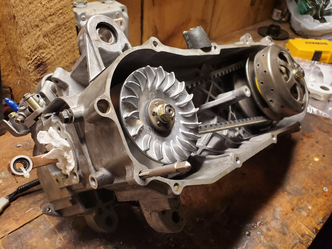

I also got around to building the transmission. I replaced essentially every component in the CVT with brand new stuff. All new washers, spacers, bendix, electric starter gear, nuts and drive face direct from PGO. The variator is a Malossi Multivar PGO New Motor model w/ Stage6 4.5g rollers. The clutch is a brand new PGO clutch with Polini green springs from a tuning kit and a NCY performance clutch bell. The primary pully is new from PGO with a NCY secondary slider and a yellow Malossi contra spring. The belt was replaced with a Dayco Kevlar belt for strength. I am hoping this will be a good setup.

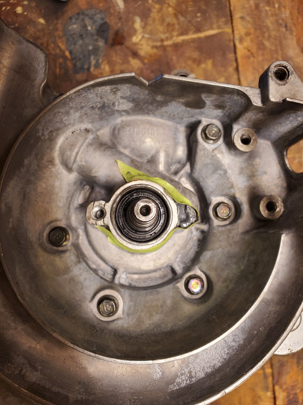

I was hoping to assemble the bottom end but the stator had other plans for me. I am not sure what happened but the stator bolt hole in the cases just blew out when I put a bolt in. I was using a torque wrench set to 10ft/lbs per PGO specs. I mixed up some JB weld and with the cracked off pieces I roughly assembled the broken cases and filled the old bolt hole. Ill use my M6x1 tap and cut a new thread tomorrow.
