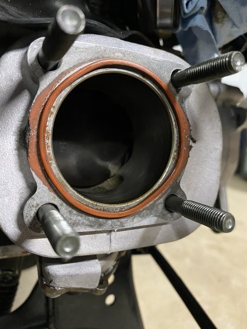

Ok got a chance to take it apart and definitely had a blown head gasket. Piston and cylinder look great though. Ended up using all the metal base baskets with a very light coat of Hondabond and no paper gaskets. Final squish ended up right at .8mm. I went with all the metal base gaskets because my piston is just above the bottom of the transfer ports so was trying to get that gap as small as I could. Currently letting everything cure and will probably try it tomorrow to see how it runs.
