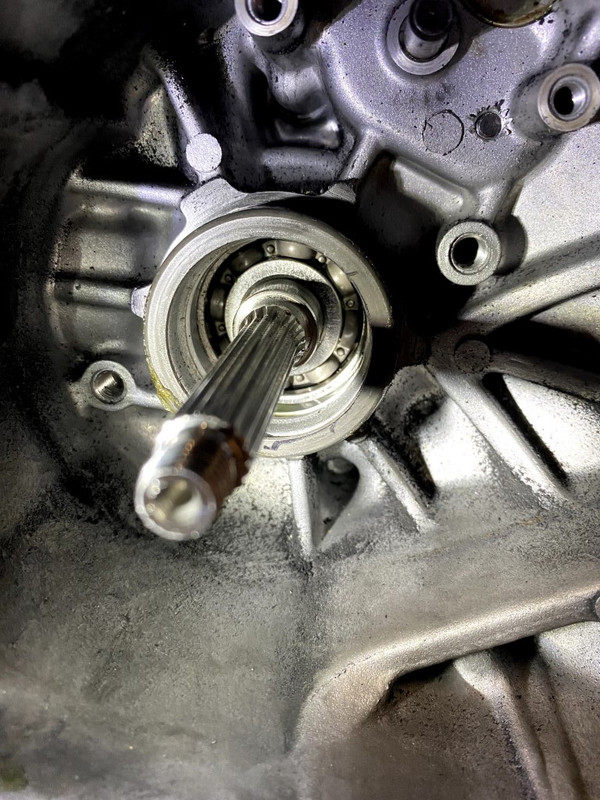

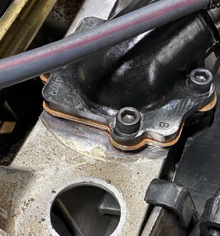

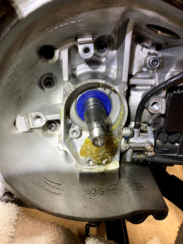

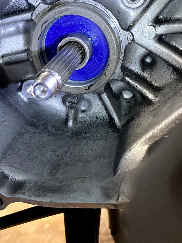

Ok an update on current status. I took the bike apart to get the new carb installed along with a new throttle setup and choke lever. I discovered my oil injection line was not long enough for the new carb so I needed to replace it which meant taking the stator off anyway. Ordered new seals so that I would only have to take the stator apart once and replace the oil line as well as the seals. I let the bike sit for a little and then when the seals came in I went ahead and replaced them. Also looked at my intake manifold and saw some signs of leaking between the manifold and reed block so I added another gasket there and copper sprayed both gaskets to make sure it is sealed good this time. At this point I am having issues with my choke cable being too long so its not actually pulling the choke when I pull the lever so I am going to just cut the cable to make it shorter and solder the end back on. Once I get the choke cable sorted then I need to install the throttle cable and adjust and then finally I can put everything back together again and start tuning the carb. I didn't expect all the little things so my carb replacement is taking much longer than originally expected but it should be worth it in the end as I got to clear up some air leak signs. Intake manifold with a gasket on bottom and top of the reed block both copper sprayed.  New NCY needle bearing throttle and grips. Really impressed with the quality for $25 from Aliexpress.   Original seal on stator side just before removal. Wood screw method as suggested from Zino worked great to get the seal out.  New seal installed.  Variator side seal removed and ready for new one.  This is what I put together to put the seal back in at the correct depth which worked great.  New seal on variator side installed.

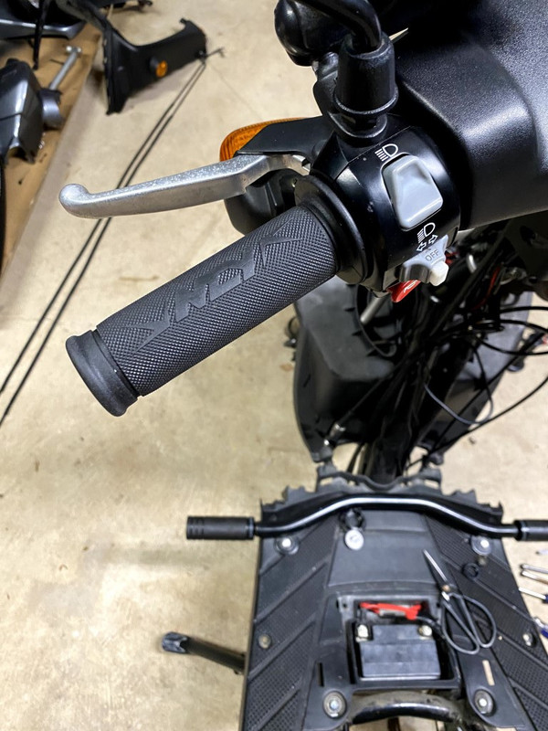

Ingram Angle, I have no words for how great those NCY handle bar grips look. You are making great progress on the build. Everything is looking good so far keep up the good work.

You have been busy! It's really annoying having to change the oil line, and bleed it. Just because it's a tiny bit short. I had the same problem when I fitted my carb. The stator side seal can normally just be hooked out. I really like the look of those ncy throttles.

Thanks guys yes things are coming along nicely! I think one of my favorite parts about the NCY grips is that they are much thicker than the stock grips so they are more comfortable in addition to looking nice and having a smooth movement on the throttle. Here is the link to those grips just FYI, there are different colors to choose from as well. www.aliexpress.com/item/32834236053.html

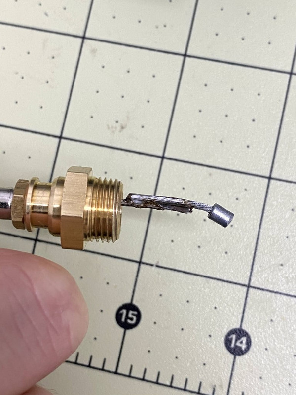

Got my choke cable all fixed up. I didn't have a cable end so I just added solder to the cable and then cut it in the middle of the solder so it wouldn't fray and then overlapped it about a half inch and soldered it together again. It took out just enough slack so that I can now actually adjust the length at the bendy on the carb and get it to engage the choke with the lever appropriately. With my other hobby being RC drones, planes, and helicopters I had plenty of soldering experience and equipment so this was super simple for me to fix up this way.

Oh And most importantly ditch the choke cable for manual choke library always the best way to go that's just my 2 cents. Ps I don't have 1% the soldering skills you Possess. So maybe you're on such another level that extra cables with random ends in adjustments are just fun for you at this point lol Thanks, are you saying go with a choke knob instead of the cable? I wanted to but on these Zuma’s it’s hard to reach the back of the carb when running stock airbox so I went with the cable just so I could mount it in an easy to reach location. When the cable didn’t adjust right I almost just bought the knob but then decided to try the solder fix which yes ended up being fun for me anyway. 🙂

What choke cable did you use? I just got the polini choke cable and am installing the same carb. The polini on the choke knob end has a set screw cable end instead of the pressed on ball. So you just trim the knob end however long needed. Looks like you had to do the carb end with the soldering.
