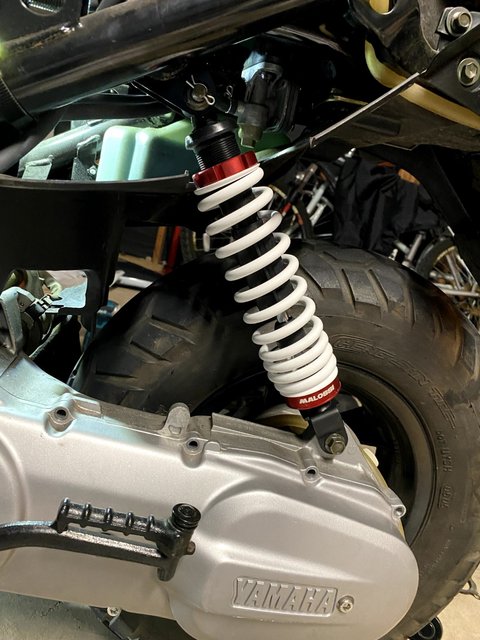

Well I decided to try the modded airbox I originally bought with the UNI filter and see if anything changed. I got more experience tuning as I tweaked many carb settings to get the best feeling but overall I am really happy with the modded airbox and UNI filter and could definitely feel a difference from stock airbox and filter for most of the throttle range. Everything is much smoother now and it kicks into the power band faster. The overall top speed is about the same as I had maxed out my variator anyway with stock airbox but definitely in stop and go and general riding around the modded airbox with UNI filter is better for me. I ended up with a 90 main jet, 1 1/4 turns out on the air screw, and needle one clip rich. So the biggest difference was I needed to go up 8 sizes on the main jet but the rest of my settings were pretty much the same even though I tweaked all of them and did many runs to determine the final result. Ended up maxing out at 10,050 rpms and 51-52mph on a straight flat 1 mile run which was my best. I even switched back to the stock airbox and filter, tried the UNI filter in the stock airbox, along with running with snorkel in and out and no matter what I could not get the same oomph that the modded airbox with UNI filter would give me with the final tune. It definitely got close with stock airbox, UNI filter, and snorkel removed but I just couldn't get it dialed in as well as with the modded airbox. This is the modded airbox which I still used the stock snorkel with it but it has an additional intake port right next to the snorkel and it has internal dividers that separate those from each other and route the air more towards the bottom of the airbox so it doesn't go straight to the intake boot. The intake boot itself is a little larger in diameter than stock as well.
The mounting point didn't line up exactly with my CVT cover so I used a variator weight as a spacer which worked just right. It has another large port on this side that can be opened up for race builds I guess but I sealed the cap on that port.  I pulled the brand new plug at the end of all my tuning and was pleased with the coffee brown color it had.
Post by twostroker on Nov 25, 2020 11:29:15 GMT -5
Oh and I installed a Malossi RS3 shock I got from Scooterpartsco while I had the cosmetics off. I thought the shock was going to be longer and raise the rear a little but it ended up being the exact same length as stock so oh well. At least now I have the ability to adjust the tension as I see fit.  That shock looks really good on your bike. Nice!
