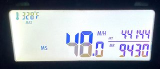

Post by ingram on Sept 10, 2020 21:09:24 GMT -5
Just to update on my troubleshooting I took the gear cover off and checked the bearings and they all seemed fine but I replaced the one on the main shaft anyway with a brand new one. That didn't change anything and I was still getting the same max RPMs (9000) and speed (49mph). I then started messing with the carb jets again and tried the 46 pilot jet with the 88 Polini main. This was too rich and I couldn't get more than about 35mph so I dropped to the 86 Polini and then everything was back to basically the same as the 44 pilot with 88 Polini main but max temps were overall a little lower (330 compared to 347) so I am going to stick with the 46 pilot and 86 main. I then tried Malossi 5.1gr rollers and my max rpms went up about 400 rpms to 9430 but top speed was 48mph compared to 49mph for the 5.5gr rollers. Finally I decided to swap back to stock gears and removed the 14/42 set and went for a test run still with the 5.1gr rollers to get a direct comparison. With stock gearing I hit 9790 max rpm at 47.2mph compared to 9430rpm and 48mph on 14/42 gears. So, the only change was going back to stock gears and I gained about 350 rpm and had basically the same top speed. The fun factor is also much higher as I definitely enjoy the low down torque the stock gears are giving me. I don't know why but it seems my Zuma just doesn't have enough power to push the 14/42 gears to their full potential and I am better off just using stock gears to get the increased torque. Max results with 14/42 gears and 5.1gr rollers  Max results with stock gears and 5.1gr rollers
One day I might try 15/50 gears as I understand those would be about 20% increase instead of 30% for the 14/42s.
