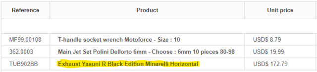

Well I got my exhaust finally but unfortunately it's for the prebug vertical Zuma and not my horizontal... Scootertronics is shipping me the correct one and sending me a label to send this one back so it's gonna get resolved but now I have to keep waiting.

Well I noticed the add on Scootertuning.ca this morning for the Yasuni R black edition which is currently in stock and discounted. I am going to have to ask for forgiveness from my neighbors in advance to installing this but I couldn't resist . Threw in a couple more items to get the free expedited shipping and about an hour after submitting my order I got my tracking number! Super excited and I will be attempting to install my BBK tonight so will follow up how progress goes on that. With the Polini jet kit it should give me additional fine grained jets to use for tuning along with the Mikuni ones I already have. As for the Silent Pro I still have not received tracking for my replacement and I already sent the vertical one back so going to attempt to see if I can just get a refund at this point.

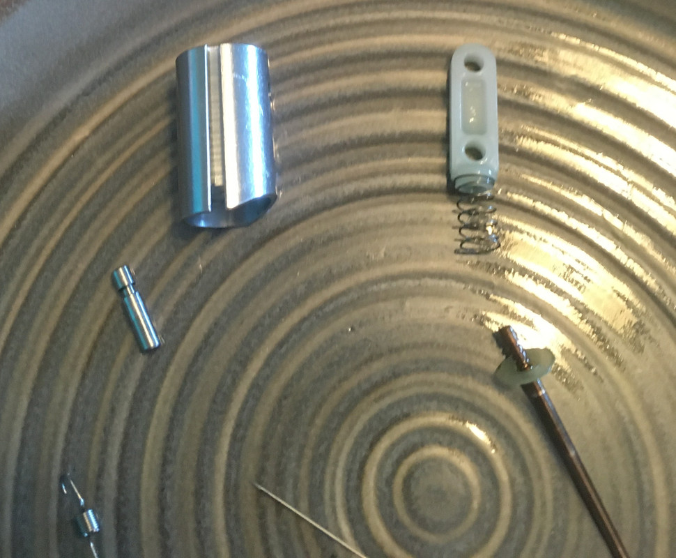

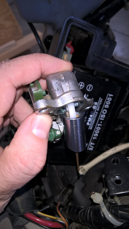

Ok slowly making progress on the BBK install. I got the carb off and disassembled but how do I change the needle clip setting to be one notch richer?
Trying to do it now while I have the bike apart so I don’t have to do it another time.
I also got the Vino pilot jet so should I go ahead and put that in now?
Post by Zino on Aug 10, 2020 21:43:09 GMT -5

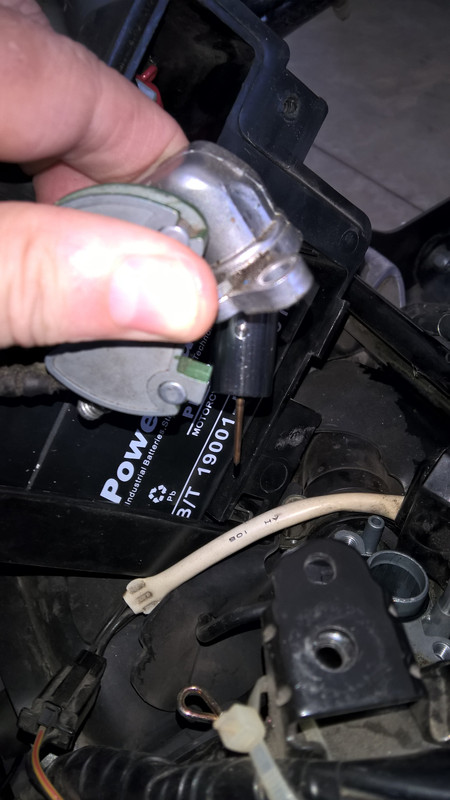

Go ahead swap in the pilot jet it will richen you up through the throttle range . I am trying to find a post or video on the needle swap . To make it richer you need to lower the clip on the needle. When you take it apart take pictures from mutiple angles the slide only goes in one way there is a notch in the throat. Here is a picture of all the interior needle parts . I use a needle nose to take the clip on and off I use a pin from my wifes sewing kit to get the spring on and off and to push the pin of the needle slide .

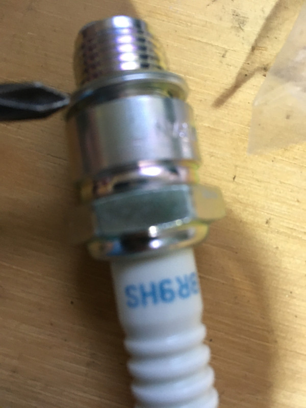

Thank you I will try to do that tomorrow then. Got the BBK installed so now I just need to set the needle clip on the carb and put it back on for a test fire. How should I install the temp sensor? I have the 14mm ring style and I assume it goes on the head and the spark plug holds it in but the wire needs to route up through the spark plug boot?

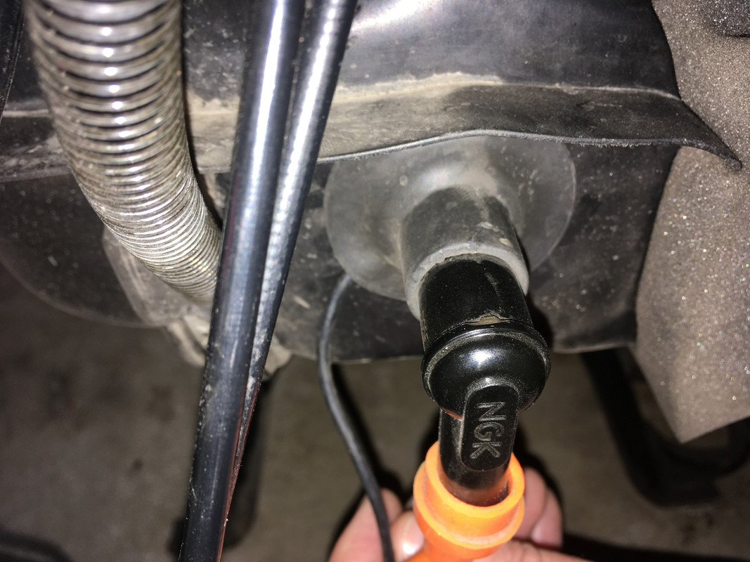

For istalling temp gauge . You need to remove the crush ring on the spark plug . The sensor takes its place . In the picture below the screw driver is pointing to it The other picture is the sensor wire coming from under spark plug boot the easiest way to get the sensor on is to put it on just a couple threads and then screw it into the cylinder head . I did not need to cut the shroud for the sensor to fit .

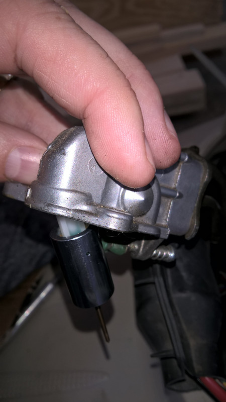

For your carb pay attention to the dimple on the pin by my thumb for reassembly The spring fits in a groove on both ends The back side showing the other side I used a pin from my wifes sewing kit to push out
