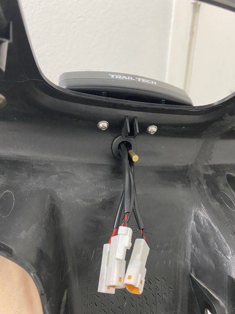

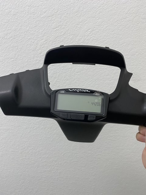

My cheap temp gauge didn’t work out so I was looking at the trail tech gauges and ended up going with the Vapor as it isn’t a whole lot more than buying the temp and tach gauges separately and gives me a full speedometer now which will be nice. So over the past few days I have been deciding where to mount it and ended up putting it just below where the stock gauge goes. I had to carefully measure where to drill the mounting holes and I think it came out real nice. Next up is getting all the sensors installed on the zuma. I got the Vapor from treatland.tv and they actually have quite a few other parts including 16X13 roller weights for $5 per set so I got me some 4.5, 5.5, and 6.5 weights now.
Post by Zino on Aug 21, 2020 7:15:33 GMT -5
Some guys just center the vapor over the stock gauges. THey Balck out the plastic and discontinue the stock gauges .

Post by ingram on Aug 21, 2020 8:24:16 GMT -5
Some guys just center the vapor over the stock gauges. THey Balck out the plastic and discontinue the stock gauges . Yes I have seen that but decided I wanted to keep the stock gauges for now to maintain the fuel gauge and signal/oil indicators. The holes I created to mount would be simple enough to cover back up if I ever decide to remove the stock gauges in the future. I have been watching the 49ccScoot videos on Youtube which are a great resource for the Vapor. Part 2 specifically shows different installation and mounting tips: www.youtube.com/watch?v=9A5oq70SG_w

Ok got the Vapor fully installed and took some pictures of the plug when I removed it to put the temp sensor in. This was a brand new plug that I put in at the same time as the BBK so this is what it looks like after only a couple runs around the neighborhood.   Speed sensor installed. I used the bolt magnet to replace one of the rotor bolts and then used the mount available on Treatland that I purchased with the Vapor to mount the sensor to one of the caliper bolts.  I found a nice spot in the ignition wiring for 12V battery source that I wired the Vapor to.  All mounted and turned on!  I added another 1/2mm shim to the variator boss and now my sharpie marks look great. So in the end I don't have any shims behind the variator and have just a hair under 1.5mm in total shims on the drive boss to get the belt all the way down.
