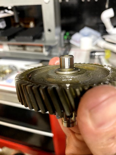

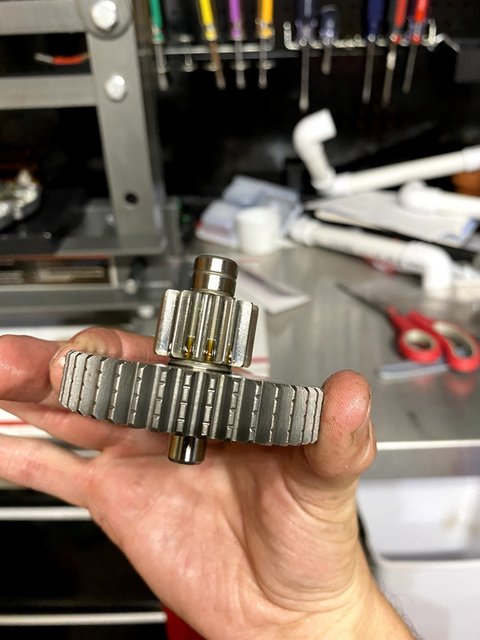

Here are the pics from my gear install. I used 14/42 Jasil pre-pressed gears but unfortunately the pre-pressed gear was not the correct size to fit in the stock Zuma bearing so I had to press it out anyway and press in the stock one to the new Jasil gear so buying pre-pressed does not mean you don't need a press when installing on the Zuma unfortunately. I ended up purchasing the 6-ton bench top press from Harbor Freight ($79) and it worked great despite me reading you need a 12-ton press online. Since I had strange noise issues originally and pulled everything out and re-pressed I was definitely glad I purchased the press as going to a machine shop (none are close by) each time would have taken me much longer. Now I have a press handy for other projects in the future. Gear box cover removed. Pictures of the gear you have to press out and noting the stock gap space to make sure it's maintained when pressing into the new gear. The 6-ton bench press from Harbor Freight setup and ready to press out the stock gear. Time to press in the new gear! New gear pressed in and stock gap maintained. Had to press in the bearing on the drive shaft and then also used the press to get it seated into the gear case cover. I completed the install by refilling with about 120ml of Bel Ray hypoid 80w90 gear saver oil after putting everything back together.
Post by aeroxbud on Aug 31, 2020 12:02:05 GMT -5
Nice job. So the head was pressed on to far when you got it?
ingram
Posts: 100
Location: Houston, TX
Post by ingram on Aug 31, 2020 12:33:51 GMT -5
Nice job. So the head was pressed on to far when you got it? No it was pressed just fine but the smaller intermediate gear shaft that was pressed in was too large for the bearing on my Zuma. The stock smaller gear on the Zuma has a smaller shaft on it so that is why I had to switch it out with my stock gear. I did read here that pre-pressed gears might be meant for the older vertical Zumas but not the horizontal ones. www.49ccscoot.com/manuals/Gear%20Installation%20Tutorial.pdf (page 4 #7)
