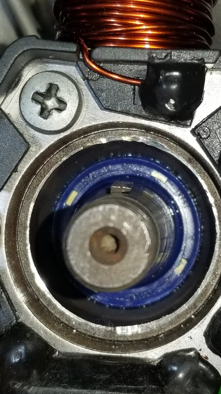

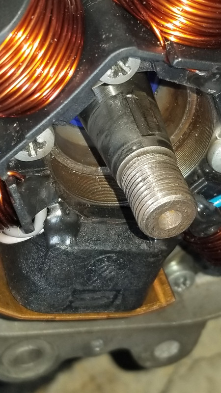

Okay so seems like i dodged a bullet for now i was real worried about damage to seal which seems to be fine thank god. I was Also wondering how I would solve my flywheel issues. Turned out after many more bumps in the road I ended up actually with a much faster scoot! Was working fine with the same key and same fly wheell after trying to use various methods to go without it With no success I however kept in still do hear a vibration noise which now I'm pretty sure is coming from my exhaust silencer bracket or at least something that's not important because there's a lot of rattling metal on this bike in places where things touch like the boost bottle for instance But a few days ago I wasn't so sure of that wanted to check if the key had come out again it had not but I made the same mistake while trying to in search the fly again And damaged the key beyond use I thought I would be out of a scooter for at least a few days then I thought to try a key made by top performance that I had and one of my extra minirally engines I had wanted to use Before on this Bike but for some reason thought the key didn't stick out far enough or something anyways it's a key that advances the timing or Retards timing by 3゚ and since my build is meant for high rebs I figured a 3゚ advance may not be noticeable but could definitely help I have no prior experience with advancing I had slotted a stater before but never ended up going through with it Turns out the key fit perfectly and am very shocked I haven't been using it the whole time Needless to say 3゚ is a world away it picks up so much faster from any engine speed I'm amazed at how much of a difference it makes definitely recommend trying it for somebody with a high revving kit and a stock Ignition

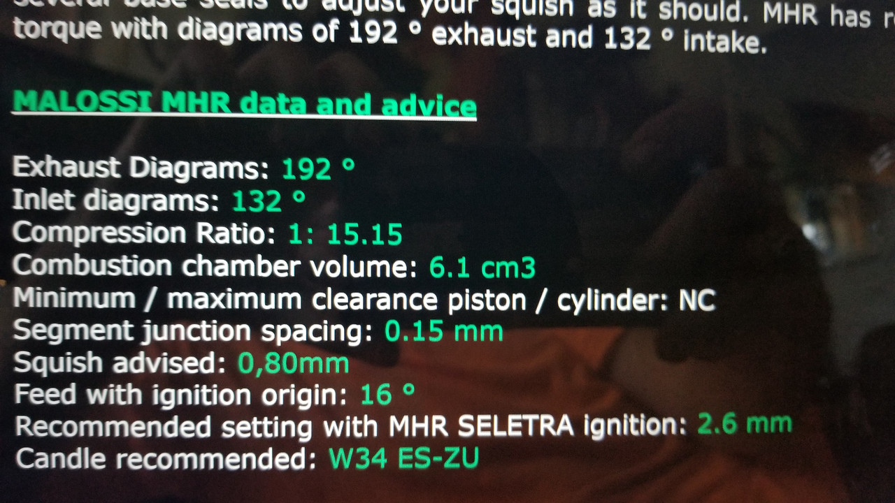

OK so here's the question I've been wanting to ask you guys for a long time I have a pipe on there that I know is limiting both the rpm as well as the fact it might not be ideal for in 86 CC I really don't have the money right now for any pipe meant for and 86 but was looking into possibly a yasuni 20-21 However they all seem to be out of stock and the only yasuni or reasonable priced pipe is on sale for 150ish i can get a yasuni r Which is a steal however I don't know if this would be much of an upgrade at all I'm sure it would be better then my current pipe a ginelli next i believe Looks almost identical to A malossi flip With a very narrow stinger looks like a pipe that could be used either on a 50 or 70 CC I'm sure this is why the engine gets hotter quicker than expected so my question is should I go for the yasuni r ? Or hold out ? Haven't been able to accomplish a top speed run and have it GPSDS when I was riding with a GPS I think I got 64 miles an hour and I was not pushing it all the way.

I think the Yasuni R and one of the C16's have a perforated rear cone inner wrap,C20&21&30 No..Yes its possible to mod a lesser pipe to work better with your engine,give me your bore/stroke,exhaust port duration and type(triple or bridged),Max RPM and I'll run the numbers on a few well known pipes and see what can be done..
Post by 808ministroke on Oct 25, 2020 19:03:24 GMT -5
I think the Yasuni R and one of the C16's have a perforated rear cone inner wrap,C20&21&30 No..Yes its possible to mod a lesser pipe to work better with your engine,give me your bore/stroke,exhaust port duration and type(triple or bridged),Max RPM and I'll run the numbers on a few well known pipes and see what can be done.. Thanks here are the specs for the durations  I was unable to find any stats for peak rpm although i know that the 77 minarelli version hits peak power at a wopping 13,500 rpm. Now i know that with the longer stroke might be lower by a bit? I also am aware these are meant to be run with a specific internal ignition but i have had goid results with stock ignitions before on my 77 mina version were i would hit approximately 12,500 rpm. I did have a better less restrictive pipe on that set up something like a koso 100cc chambered pipe. I can give you dimensions if it would be relevant. Appreciate your input.
