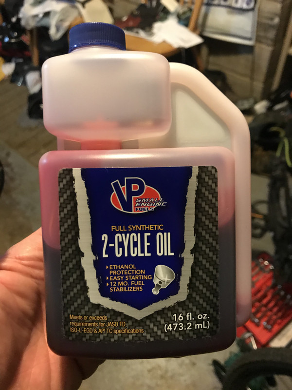

I’ve taken to carrying this along under the seat for gas station fill ups.
Post by Steve B on Oct 16, 2020 9:09:15 GMT -5
I always liked those E-Z fill containers.

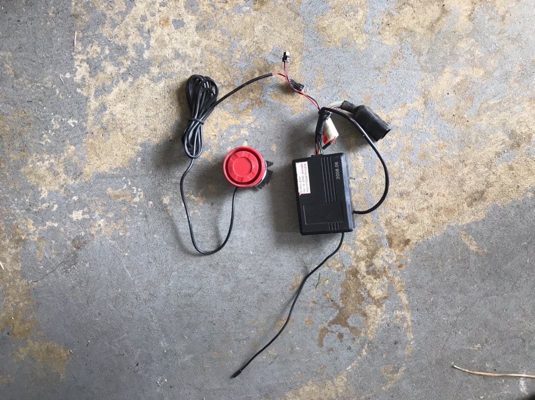

 Is this part important? Looks like an immobilizer alarm of some kind. Bike is on a diet, losing weight.
Post by aeroxbud on Oct 18, 2020 15:29:12 GMT -5
Looks like an alarm. Normally more trouble than they are worth.
