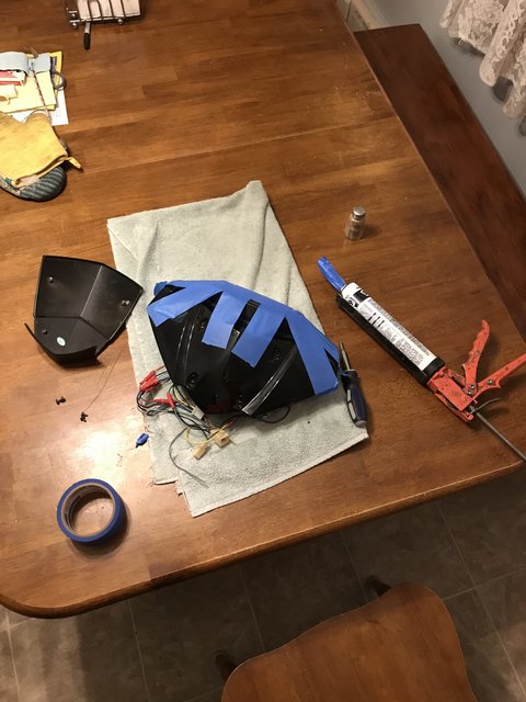

The directions are in very bad English. Over half of the written programming doesn’t make sense even if I try to use alternate words. The “oil” meter is actually the fuel meter. Several wires listed do not exist, the “speed signal” wire is the wrong color and is for the tachometer. Last night I got turn signals, high beam, constant voltage and key on voltage, tachometer and fuel all sorted. Today I need to glue the magnet to the wheel and run the sensor wire. Fitting it into the dashboard will require some black plastic magic and some sawing. Perhaps even some black caulk to hide the edges.

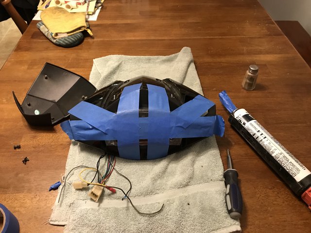

Post by captincvmn on Nov 1, 2020 18:44:07 GMT -5
Mid surgery We’ll see how it turns out after it sets.

Steve B
Scoot Veteran
Posts: 831
Location: Derby,Iowa
Post by Steve B on Nov 2, 2020 8:30:49 GMT -5
Looks like it belongs on there. Nice job.
Post by 90GTVert on Nov 2, 2020 11:08:19 GMT -5
Most people probably wouldn't realize it's not original equipment.

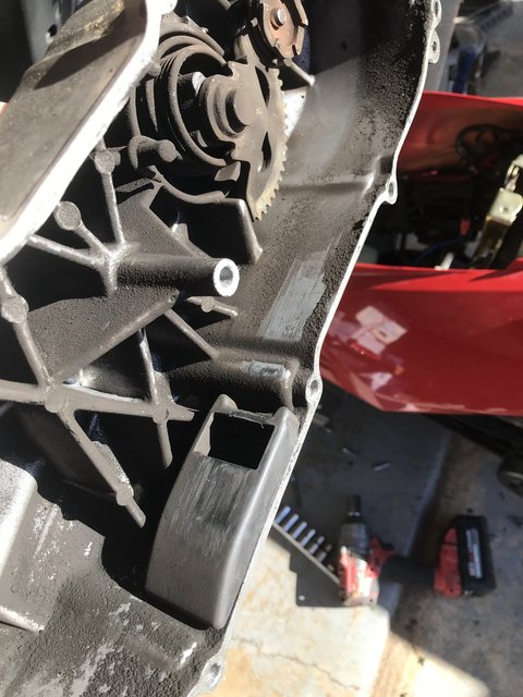

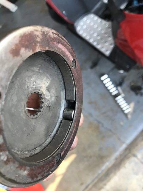

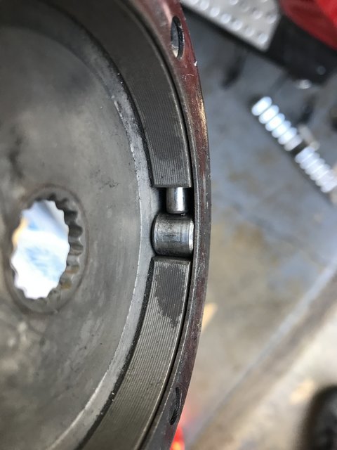

I’ve been having starting issues. Starter has been laboring and the kick start is audibly turning the starter. Hmmm, this morning I dug into it and found the one way bearings were crusty and nasty. All better now.

Post by captincvmn on Nov 8, 2020 13:02:31 GMT -5
I guess I’m getting enough belt travel. It’s either slapping or rubbing the case when it’s on the outter rim of the rear pulley. The front pulley is NOT running all the way out. Looks like I have 3/8” of travel left. Might have to study on this. On the bright side the kick start works better now than it ever has since I’ve owned it. Amazing what a little lubrication can do.
