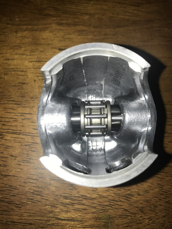

  A little faster, don’t mind if I do. Serious question though, I bought a bearing with the same dimensions as my original 50cc and I’m concerned about the end gaps on the bearing. I think I should have a bearing that is 5mm wider???
Post by 190mech on Dec 27, 2020 17:31:00 GMT -5
Cool,they make a nice kit..Pin bearing should be OK as it'll still have the rollers within the rod,but a wider one certainly would'nt hurt..

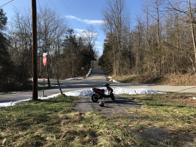

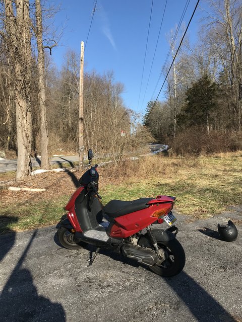

Post by captincvmn on Dec 28, 2020 13:22:42 GMT -5
I’m starting to feel very Brent like. Broke down in the middle of nowhere looking for a friend with a truck. 😢
Post by captincvmn on Dec 28, 2020 13:42:50 GMT -5

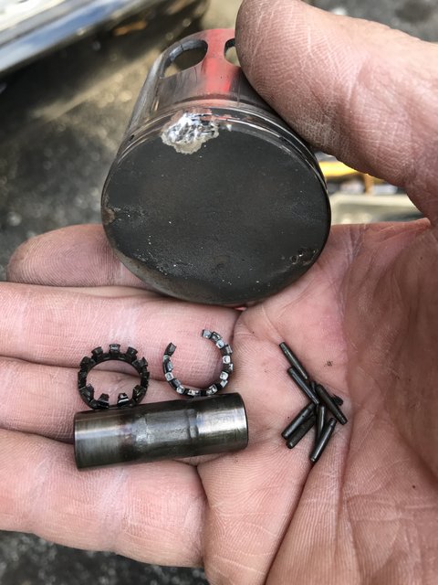

The Naraku cylinder I’ve been running for 4 months must have swallowed a ring. It’s stuck fast. Won’t budge with kick start. Died coming down a hill, which has happened to me before. I’ve written it off to electrical gremlins in the past. Today it coasted to a stop and then I cranked it once, it “almost” spun properly then quit. Then I tried kicking it. (The start lever not the bike). It spun some then locked tight. Totally tight. I’ve heard of the soft seize before but I don’t think this is it.

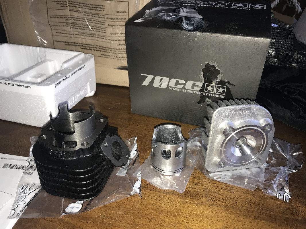

that sucks pull the head and see how bad the damage is .
It might just your scooter saying put the stage 6 cylinder on me .
