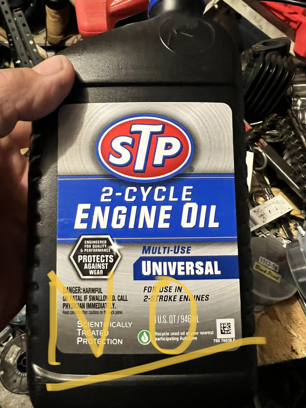

Post by 190mech on Sept 25, 2022 18:07:51 GMT -5
What kind of oil were you running when the ring stuck?? You have some kind of Pod filter on there or a good 'ol stock airbox?
Post by captincvmn on Sept 25, 2022 18:52:50 GMT -5
190mech
Post by 190mech on Sept 26, 2022 18:38:57 GMT -5
Mercury Ouicksilver multi use works well for a cheaper oil!!
