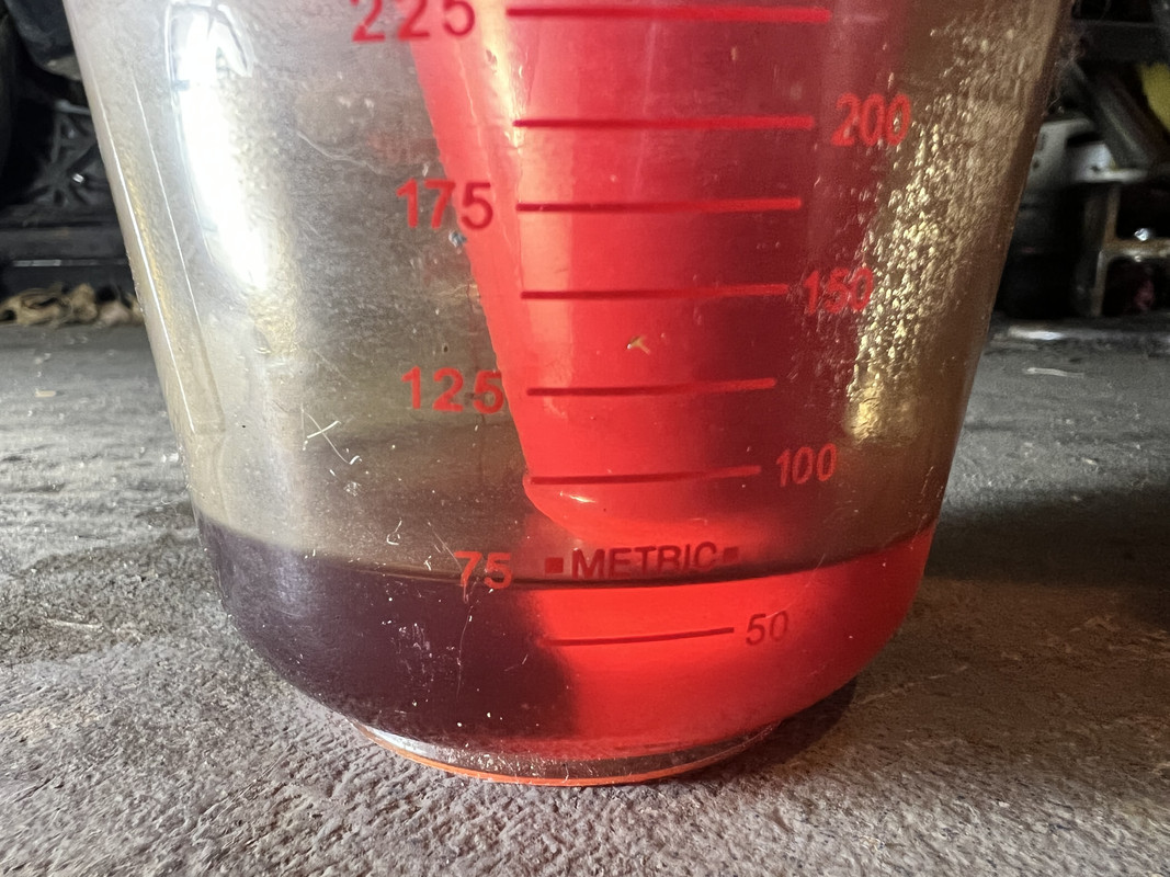

Well, Sunday went for a ride, temps in high 200°’s. Around 270°, soft seize (maybe) at the end of a long uphill. Either way it shut off. I let it sit roadside for 3-4 minutes. I thought that’s bullshit, I had upjetted, it wasn’t hitting high RPMS, hanging around 8k, could it be fuel starvation again? It started, felt down on power, I went home.
FF to tonight. Pulled the bowl drain, ran 30 second drain test. Less than 75ml in 30 seconds. Still that should be enough to get me up a long full throttle grade. There’s no way I’m using 75ml in a 30 second period of full throttle. I’m not running a Top Fuel Funny Scooter. Swapped jet down to a 77 from a 79. Takeoff felt better, didn’t bog (as bad) when clutch engaged but it still isn’t that nice smooth entry into takeoff, it ramps up, engages, drops out of power and then eeks back into it. Not ideal. Went for a ride of the same path as Sunday. It’s cooler out today. I didn’t get as far before it shut down on my again. Temps were 260-275°F? First thought was fuel but I did try to kick it right away this time but no dice. I had to let it sit for 5 minutes before it would go. It started very hard and was down on power again to ride away. Rode more, back toward home. Past home, around a lap where there is a longer uphill grade. Made that hill no issue. Made a second lap. This time wider throttle setting, go to top of hill and throttled back to turn into my road. It died.

Post by captincvmn on Sept 29, 2022 20:13:27 GMT -5
30 second drain through carb bowl
