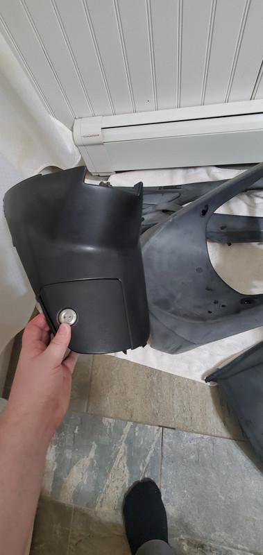

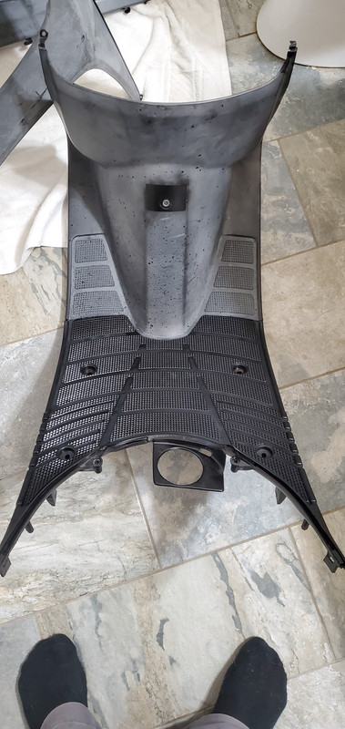

I started by bringing all my plastics inside overnight to warm up. This morning with some Purple Power and a nylon brush I cleaned every faded plastic in my bathtub. Once everything was degreased and clean I rinsed them off in the shower with very hot water. I let them dry on my bathroom floor for at least a few hours.

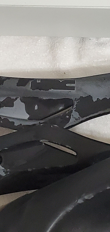

Some plastics had some decals from the previous owner. I debated leaving these on as these were original Japanese stickers from the 90s but I decided against it. With the Dio 2 ZX being a rare model already and exceptionally rare in the USA I wanted the panels to be bone stock. I broke out my heatgun and peeled off the old stickers. Here you can see where a Honda HRC sticker used to be. It was on there so long the plastic underneath still looks new.

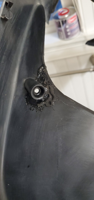

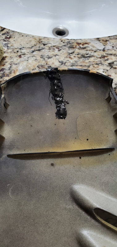

Some of the plastics were damaged when I received them. The nose plastic and cowl that surrounds the wheel both had some cracks. Fortunately another hobby of mine is electronics so I keep a very nice Hako soldering station. I fitted a very wide chisel tip and welded the cracks closed from the inside of the panel. I then used some old zipties (made of ABS like the panels) as a sort of filler rod to further fill the gap. I also had some JB Weld plastic weld lying around so I used that to further strengthen the bond and touchup the black areas. Its not perfect but I am happy with it for now. The bond is strong so I don't have to worry about any further damage.
