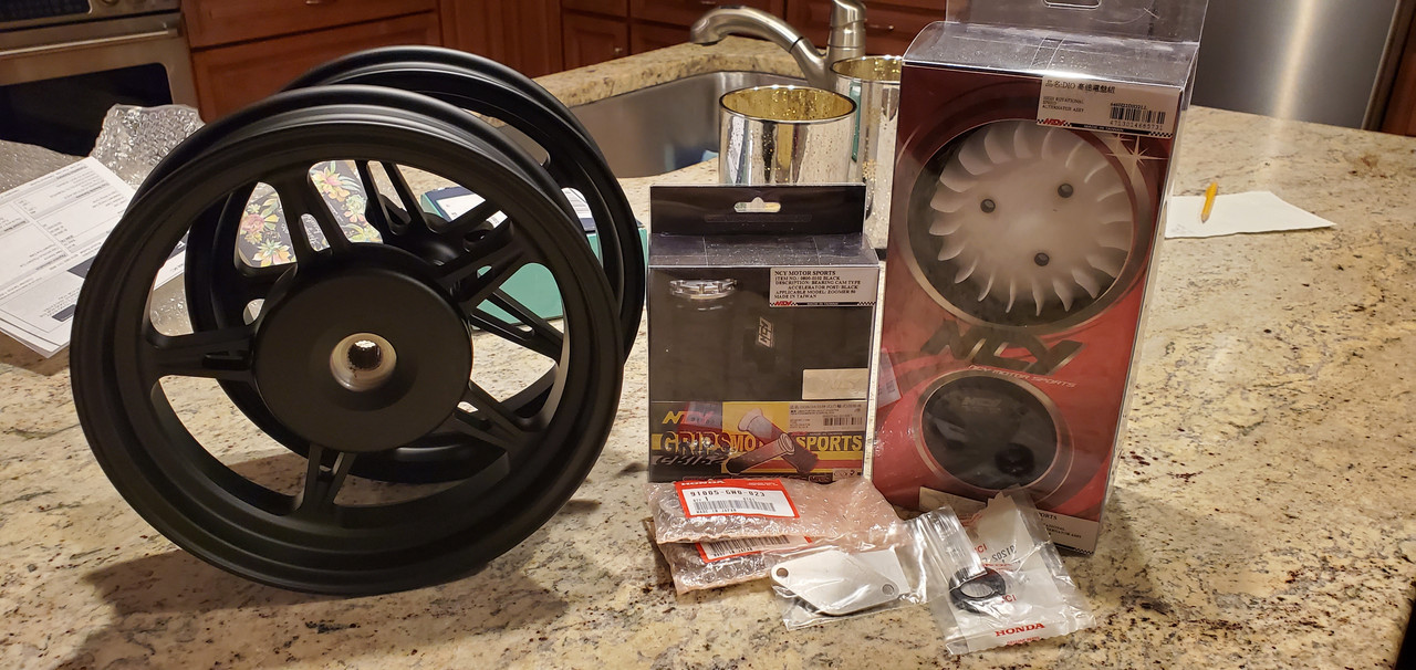

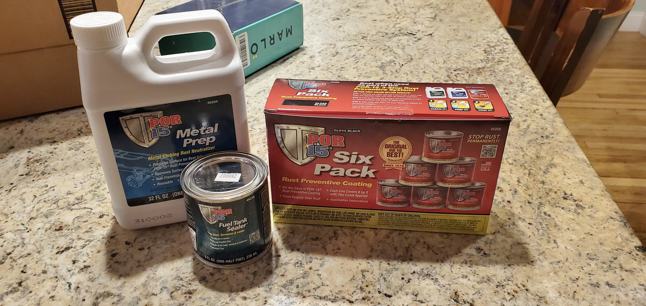

The last of the parts came in today. SSS NCY Racing Ignition NCY needle bearing throttle Michelin S1 tires Billet Aluminum wheels OEM Honda bearings and Seals Starter Block off plate POR-15 supplies to seal tank and paint frame ![](https://i.postimg.cc/B6jm7rjx/20210304-213615.jpg) ![](https://i.postimg.cc/8cWtNLBc/20210304-214929.jpg) ![](https://i.postimg.cc/BvQYHLs7/20210304-215022.jpg)

Nice rims!

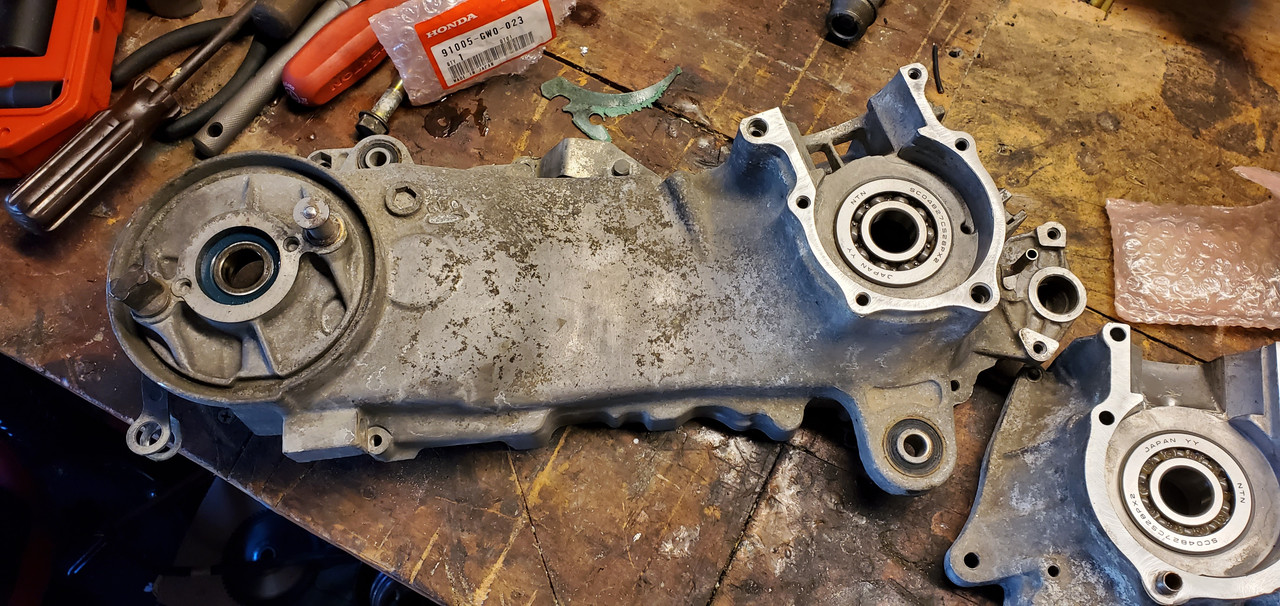

Anyone have any tips for seriously degreasing an engine case? Any tools yall use or chemicals?
I hit this grease with chemical degreaser, purple power, brake cleaner and a brush on my Milwaukee drill on high speed and nothing. Nada. This grease is like paint.

soda blasting..
Post by hippo008 on Mar 7, 2021 19:42:35 GMT -5
Oven cleaner is the sauce. I had used it before for cleaning brake dust at work and tried it on this engine case. Boy did it clean right up.
The grease was *really* on there. I put the cases in some very hot water and detergent and I think they somehow came out worse. I scrubbed with some scotch Brite and Super Clean and all that happened was this very sticky tar like substance got everywhere. It wouldn't come off my hands, even with some Fast Orange Extreme.
I hit it with that Easy-Off and BAM the grease was loose! A small plastic brush was all I needed to clean it off.

I decided to cheat on degreasing. I sell autoparts to a lot of local shops including a local transmission guy. I rang him up and asked if he'd put my cases into his hot tank and parts cleaner. He's been a longtime customer and was happy to help!
So tomorrow morning I'll have some perfectly clean cases. I never thought to tap my commercial parts customers for help before. Just to maintain a positive relationship it probably won't happen again. I'll post photos tomorrow!

Oven cleaner is the sauce. I had used it before for cleaning brake dust at work and tried it on this engine case. Boy did it clean right up. The grease was *really* on there. I put the cases in some very hot water and detergent and I think they somehow came out worse. I scrubbed with some scotch Brite and Super Clean and all that happened was this very sticky tar like substance got everywhere. It wouldn't come off my hands, even with some Fast Orange Extreme. I hit it with that Easy-Off and BAM the grease was loose! A small plastic brush was all I needed to clean it off. I have had corrosion issues using easyoff on some types of aluminum parts...
Post by hippo008 on Mar 8, 2021 20:45:04 GMT -5
I heard that too 190. Apparently easyoff is an issue with aluminum. I cut through the grease and let it sit in a tub of water overnight. I didn't have any issues as far as I know. I may end up spraying the cases with some cast aluminum paint to help even out the color.
