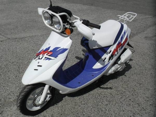

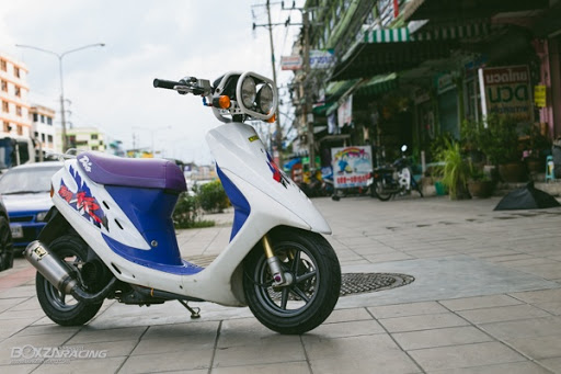

In case anybody is interested, how cool are these Dio Bajas?! That awesome colorway, the bars, the lights, the gauges, totally awesome and unique. When the roughhouse gets sold I'm looking to bring one of these stateside under the 25 year exemption.
