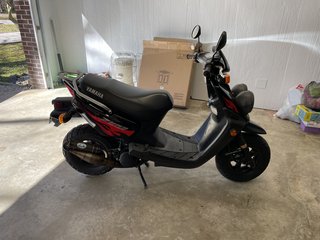

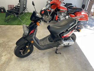

![](https://i.postimg.cc/YSZm4Qrv/1-D9-EADBF-83-D2-459-B-824-D-9-A59-B2-FF8077.jpg) ![](https://i.postimg.cc/gjqwB5vh/C68-CF4-C1-90-CE-49-EF-B2-A9-8-EC6709-C4314.jpg) Here she is. Took her for a speed run today & hit 43.67mph on the flat. I weigh 260lbs so I felt like that is decent. When I get the boppers installed I’ll do it again & see if I get any improvement. Then will do the same when the sliders come in, & last when I install the 15/50 gears.

Low 40's with a 2005 sounds about right with the Leo vince zx . If you want more Top End . A carb will help support the exhaust and kit and get you a few more rpms up top and give you better take off . The 2005 14.6 final gear ratio holds you back the 15/50 gears will add 6-8 mph by themselves .

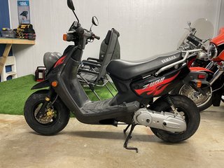

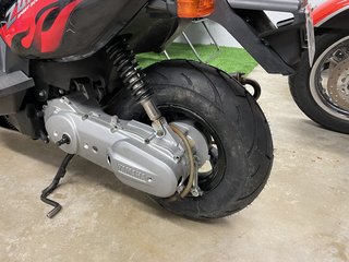

![](https://i.postimg.cc/Gpp56VHY/200-ED642-E76-E-4-D33-8737-EF8-AE3-FB6003.jpg) ![](https://i.postimg.cc/9Qbk8CFC/298-C677-C-3-D20-4-B68-AF4-D-7-AF3-F20-EC6-BB.jpg) Got the new shoes put on this evening. 2 big screwdrivers & a ratchet strap had it done in about an hour. It was after dark so I didn’t take it for a spin. The rear shinko knobby was about half worn but the front stocker you could see the air in LOL. I figured low 40’s was about right with the gearing. My old 09 with the same setup was good for 50-52 cruise. I was about 35lbs lighter then however.
Post by CrankingWithCG on Jan 21, 2021 3:21:40 GMT -5
Im 190 pounds with a bit more aggressive of a setup and im hitting 44-45, so that sounds pretty good
