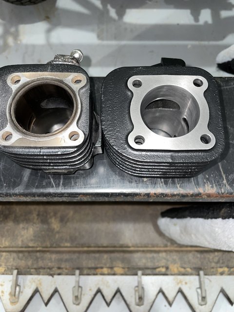

Post by bigmatthew86 on Jun 23, 2022 18:29:15 GMT -5
  Few pictures showing the difference between the street race & the top performance cylinders.
Post by aeroxbud on Jun 24, 2022 14:28:07 GMT -5
Quite a difference in port size.

Post by Zino on Jun 24, 2022 18:21:30 GMT -5
The size of the stage 6 ports stand out . That should have plenty more Torque . Whats the squish that you set that cylinder up with ?
I have a used Trophy cylinder on my shelf its ports are similar in size to the Malossi Sport the trophys port timings are just a notch faster .
I prefer the o-ring heads so I never ran the trophy on any of my scoots.
Post by bigmatthew86 on Jun 24, 2022 20:40:42 GMT -5
I didn’t even set it. Just bolted it on. The trophy ran good. I actually had it on a Zuma I had about 10 years ago so when I this I went back with it. O ring head is definitely better but I never had an issue. Probably should have tried something different this go round but it worked out. The trophy is running strong on the vino now.
Post by Zino on Jun 25, 2022 10:32:13 GMT -5
I know the Trophy always got good reviews and was a go to kit on Zuma Forums ,The scoot I got the Trophy off had plenty of power ,
The Stage 6 Sport Pro comes with multiple gaskets sizes to set squish .
If you want to dial in your street race tighter you could grab the athena/stage 6 gasket set .
