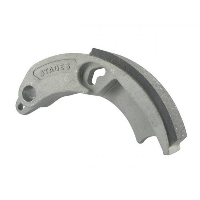

Anyone know which spring location adds tension on the s6 sport pro clutch? I’d assume the top location would make it harder to open but I’m not sure & it doesn’t say anything about it.

This is what I’m talking about if you’re not familiar with this clutch.

So I got the clutch & bell installed. I went with the stage 6 medium springs in the closest in position. They were a huge pain to install! I also ended up moving from the malossi white to yellow contra. I was netting about 3-400rpm less with the new clutch on the old setup. Going to the yellow got me back. New clutch definitely grabs harder. I want to try the other spring position. Also am running 7g rollers so I might try to lighten them a little to see what happens.
