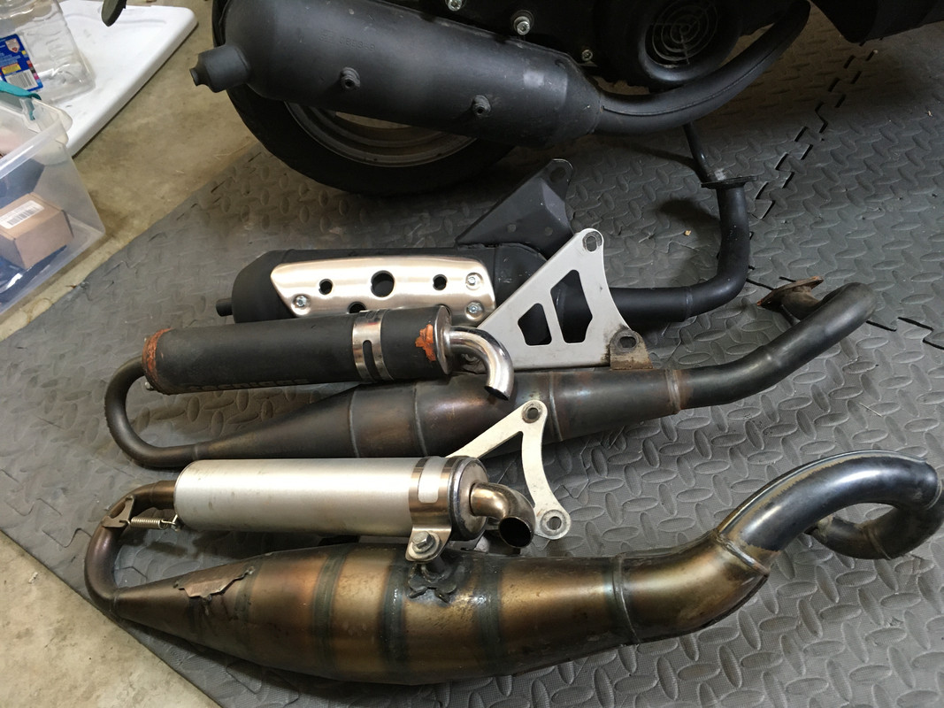

Here is a side by side from top to bottom malossi wild lion ,tecnigas silent pro ,tecnigas next r and Yasuni R The yasuni belly is wider and has more volume . You made a great choice for and expansion pipe The yasuni is the bets of these 4 pipes I Have run The Leo vince zx and would any of the first 3 pipes right there with it the yasuni r just has more power hands down. i would buy either of the street pipes over the zx and next r since the the power band is wider and requires almost no cvt tuning over stock and top speed is the same .

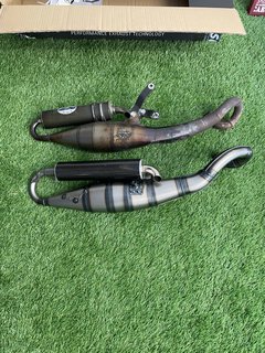

Post by bigmatthew86 on Mar 11, 2021 18:09:58 GMT -5
Got the pipe in today. Pulled the restrictions & got it mounted. Definitely an improvement over the zx. I need to do a little cvt tuning but just slapping it on & going is netting 250-300rpm more. I can get up the hill by my house about 3-4mph faster than before. I went up 2 sizes on the main & still need to go up another size or 2.
