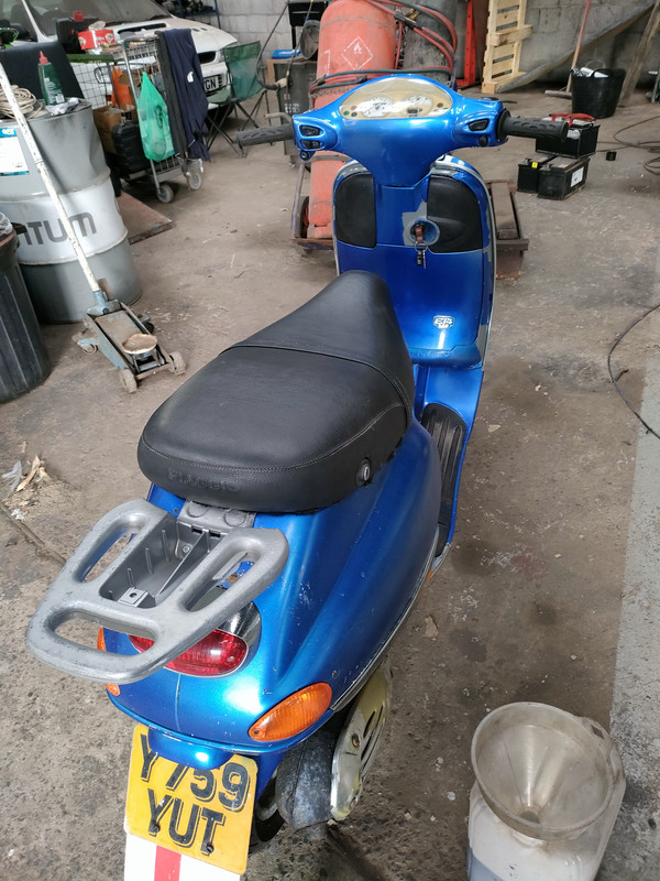

Post by milly on Oct 25, 2021 17:13:12 GMT -5
Young lady bought it with all its quirks spoke to her and she happy as a spares kit for hers or do it up at some point. Paid deposit and collecting it in the week or next.
Post by milly on Oct 26, 2021 15:27:01 GMT -5
Oh well I am now being paid to deliver it to her Thursday.
Post by milly on Jul 27, 2022 17:22:46 GMT -5
Well what do you know this one may well be coming back to roost. No change in it still spluttering etc even after her dad looked it over so I just want to get it going properly out of pure stubbornness.

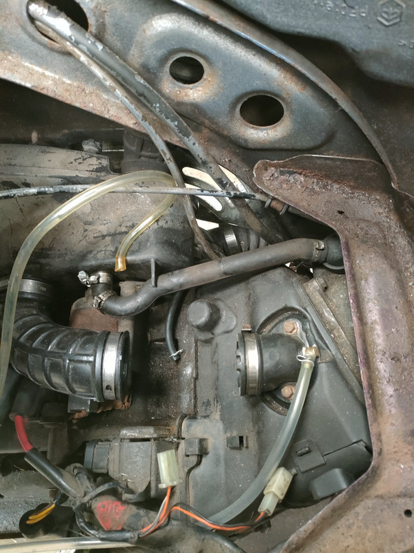

Post by milly on Aug 26, 2022 12:03:12 GMT -5

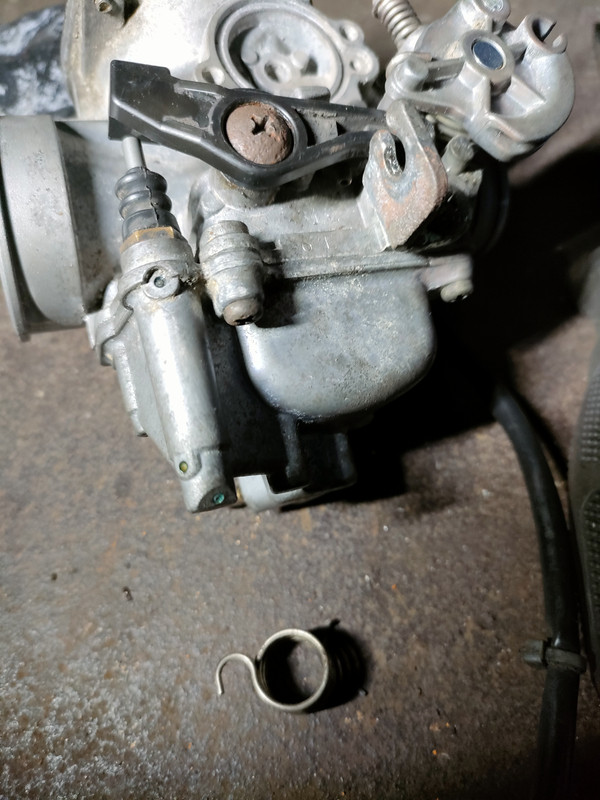

Today took a crusty carb off a old skipper engine and cleaned it up. Have a spring left over I can find no place for😲

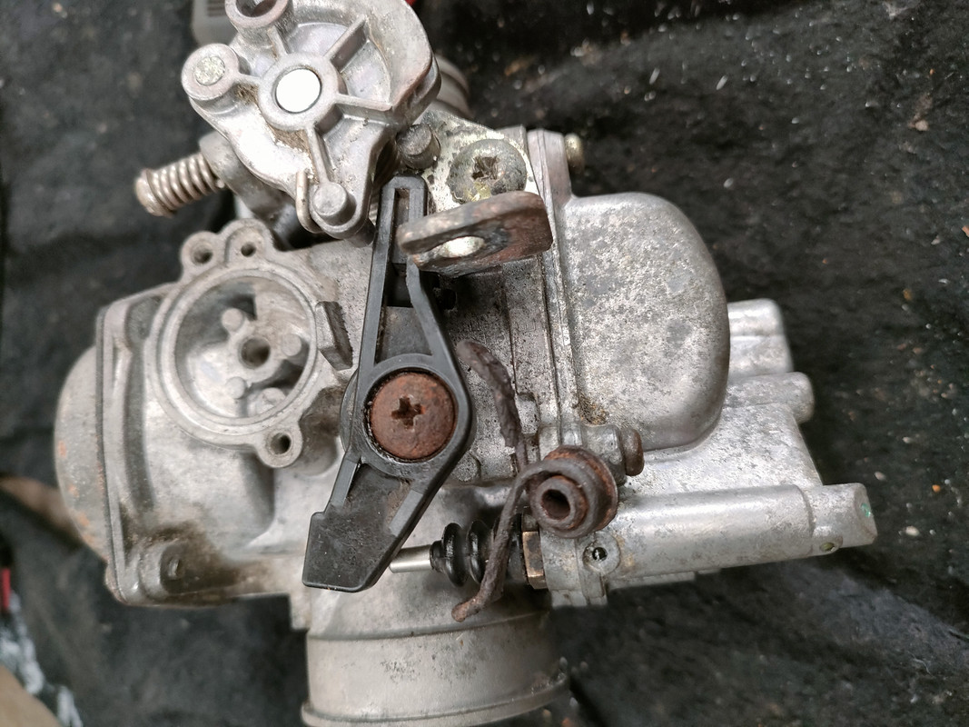

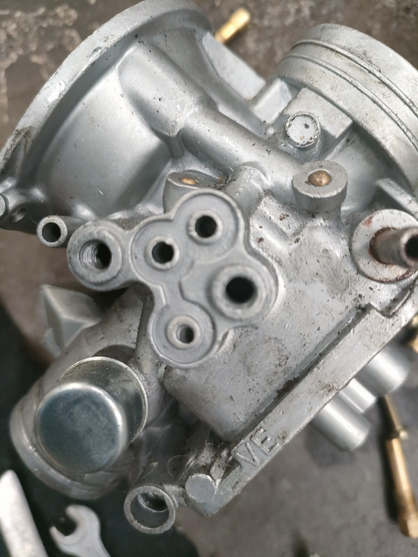

Post by milly on Aug 26, 2022 12:06:51 GMT -5
Took old carb off and stripped just to see anything amiss. Noticed gaskets for auto choke.not there. This was a brand new carb. I know she said her dad stripped the carb but if this the problems all along will be very miffed.
Post by milly on Aug 26, 2022 12:34:58 GMT -5
Mystery of the spring solved. It's part of a brake shoe or disc pad that had been left on the ramp by mechanic yesterday 🙂

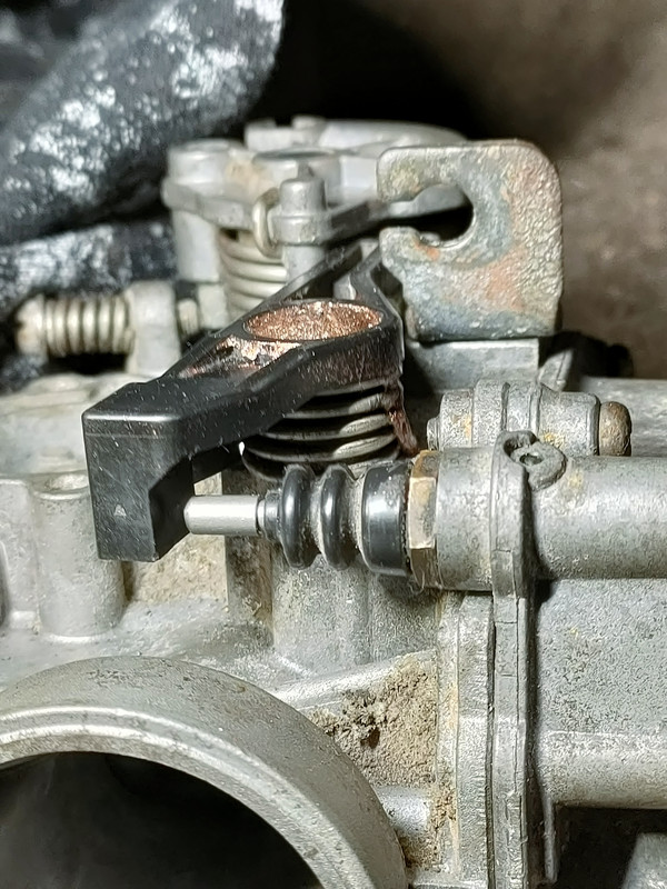

Post by milly on Aug 28, 2022 14:59:28 GMT -5
Together but still sure needed a spring to assist accelerator pump to open. Looked couldn't see so remembered what I was told decades ago. Wait till it's dark and look again with a torch. Found within a minute tonight and now back together ready to go on 🙂
