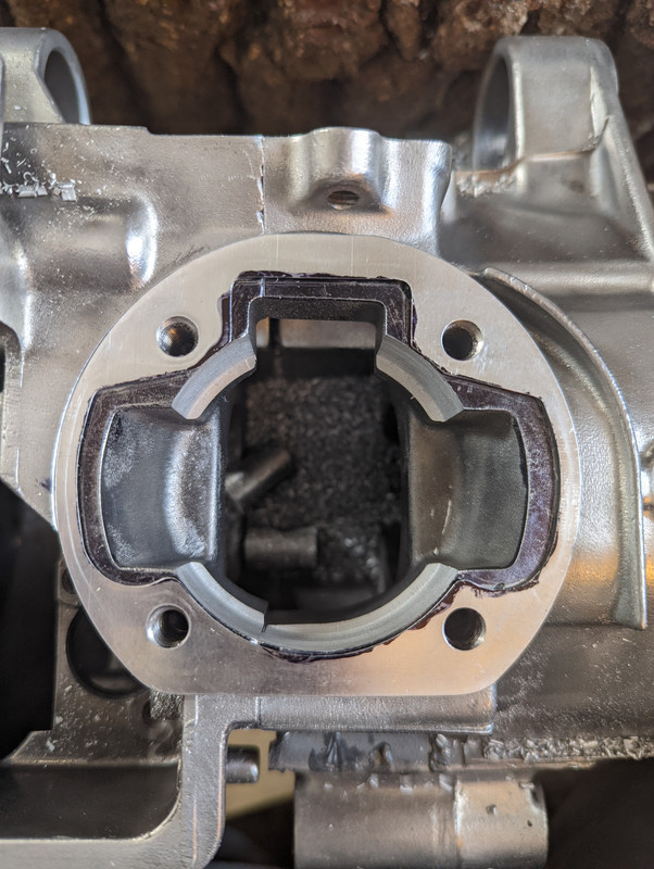

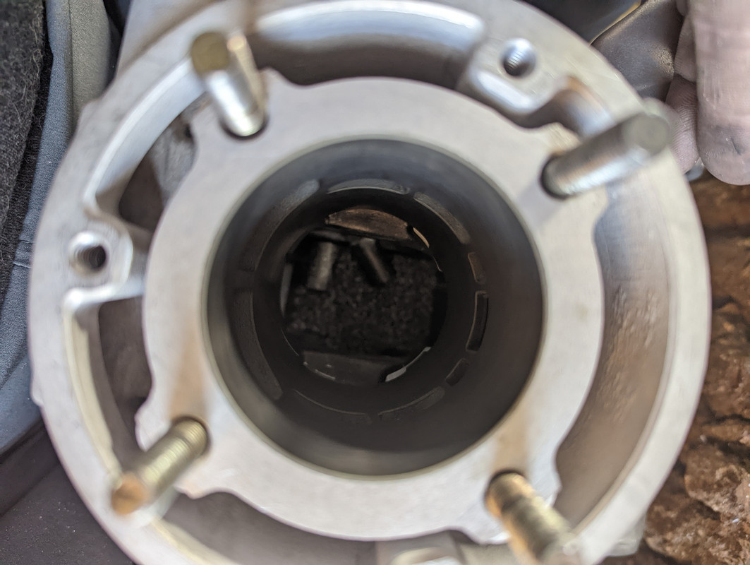

Doing this post on my phone, hope I selected the right photos 😅 Anywho, got the case cutter in the mail yesterday. Cut the bore just tits on the dot wide, wicked. The bore cutter bit chipped at the point and dull and I was hesitant to shape it because it's not mine, but I did and then it cut sooooo fast. My only mistake was sinking the bore a bit under 1mm deeper than I meant to, it cut so freaking quick with a sharp bit. Note: in the top pic that's the base gasket on there lining up perfectly with the cut I had just made. Did the crank areas as well, but didn't get a pic yet. They're bolted up, I wanted to see how close I got them. Maybe 0.2mm off at most in a couple places, they match magnifico. I'll add pics later. The case cutter holes didn't line up perfectly, my holes were about a millimeter wider apart. Again, not being mine, I didn't want to drill a new set of holes in the base plate. This is a non-consumable, though, so I didn't. I got the hole that centered perfectly very snug, and cross threaded a bolt in the other side a bit to cam it in place, worked fine. On the left side case it was a non-issue, those holes aren't threaded and have enough wiggle room. I need one of these! Will be taking some notes 😉 More pics later.
