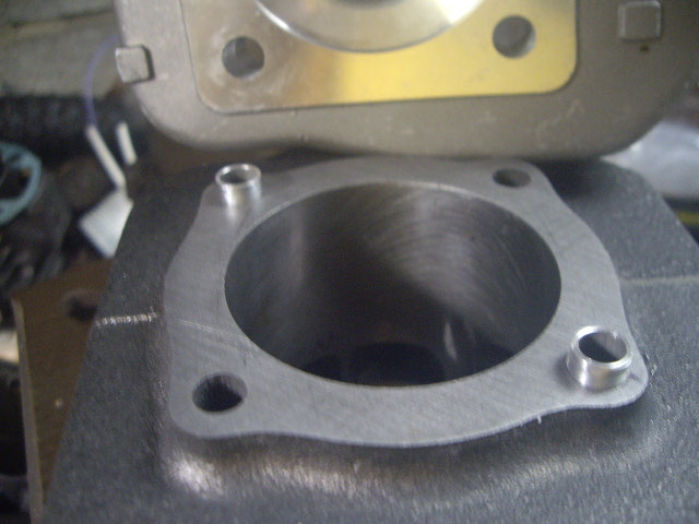

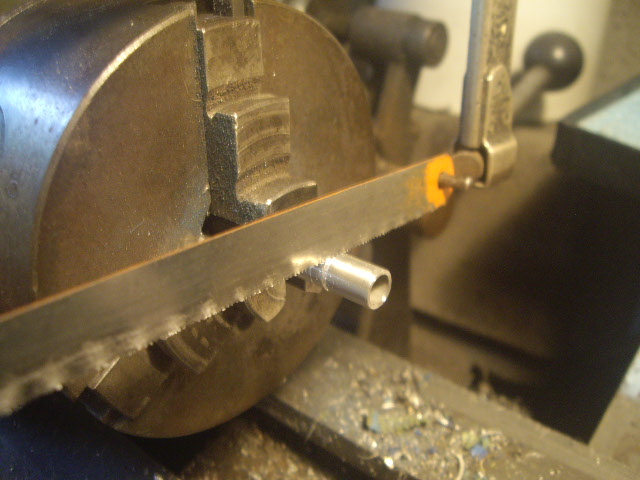

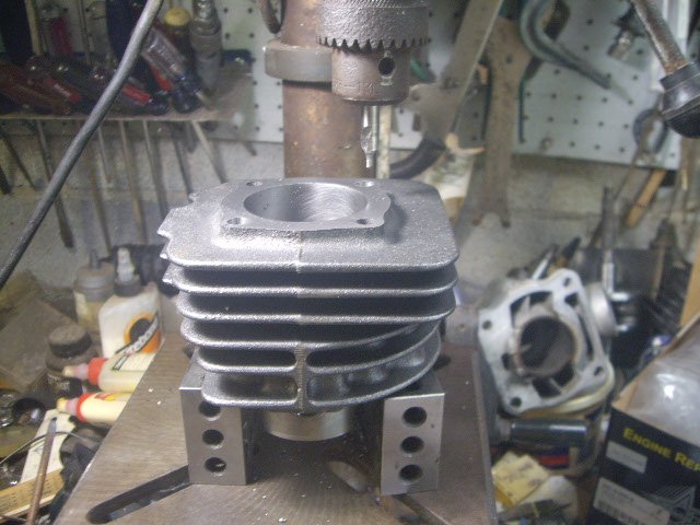

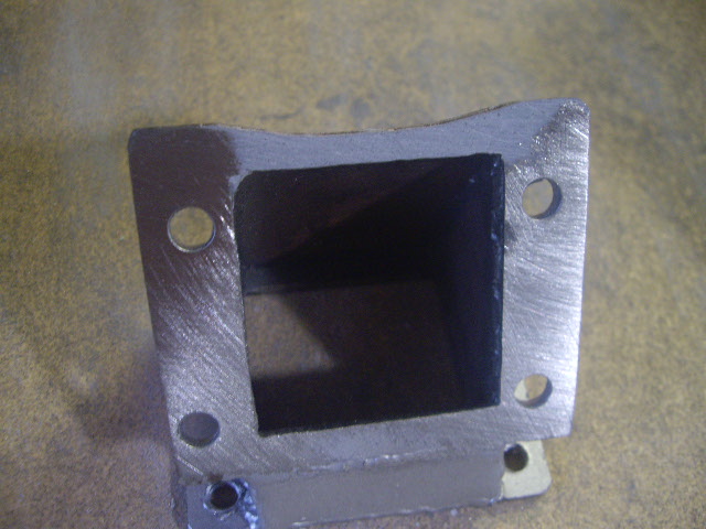

Got the cases assembled,went to check final cyl/head/squish assy and found a super sloppy fit between the head and jug..Did a dirty dowel fitment using a 5/16" center drill in the drill press,used 5/16" aluminum tube for dowels,worked out kinda spiffy! ![](https://i.postimg.cc/bwx7wy7P/af16-head-dowel-1.jpg) ![](https://i.postimg.cc/mrVK7dZ6/af16-head-dowel-2.jpg) ![](https://i.postimg.cc/QNBxx70r/af16-head-dowel-3.jpg) My hand made 'sheet metal intake' had some warpage due to welding on the bottom flange,just couldn't sand it out,,Mixed up some JB weld and filled the low spot and it is now flat like this planet! ![](https://i.postimg.cc/vm63Z3gV/af16-reed-epoxy1.jpg) John u aiming with lining straight up with Mani insteaded off the angled setup?
