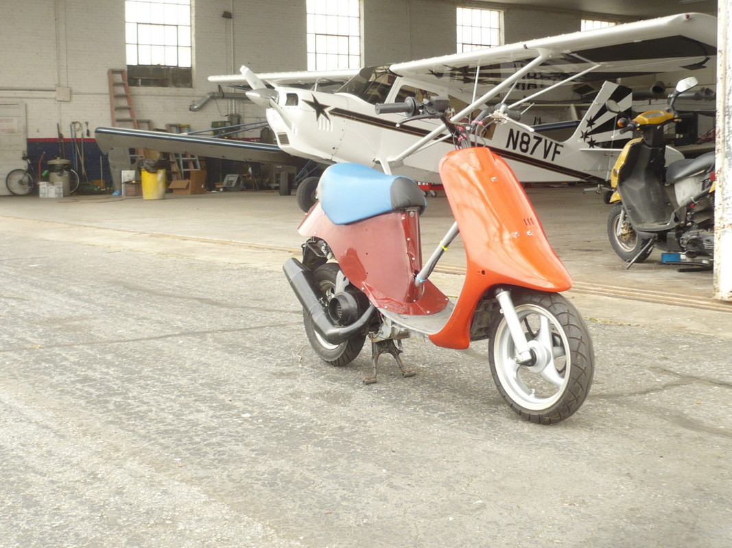

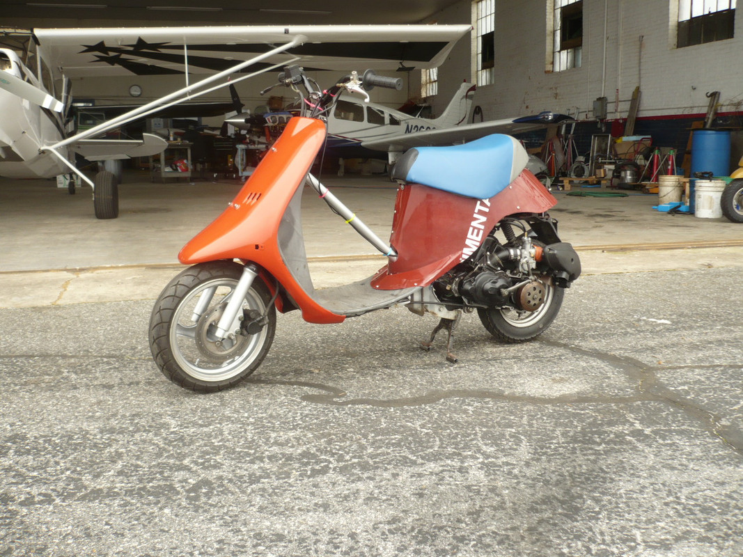

Post by 190mech on Mar 3, 2020 8:46:19 GMT -5
Got the Elite "CR" out to the shop,its getting well broken in by the young lady A&P mechanic I have working with me.. ![](https://i.postimg.cc/FsNTpWKj/elite-cr-shop1.jpg) ![](https://i.postimg.cc/8z3d2tTX/elite-cr-shop2.jpg)

Got the Elite "CR" out to the shop,its getting well broken in by the young lady A&P mechanic I have working with me.. ![](https://i.postimg.cc/FsNTpWKj/elite-cr-shop1.jpg) ![](https://i.postimg.cc/8z3d2tTX/elite-cr-shop2.jpg) That seat fairing is made out of aluminum? Looks awesome!!
Post by 190mech on Mar 3, 2020 11:38:01 GMT -5
Its an old 1/16" lexan windshield out of an experimental aircraft,I just left the stickers on it and painted on the underside..Poor man's Art!! ![:D](//storage.proboards.com/forum/images/smiley/grin.png)
