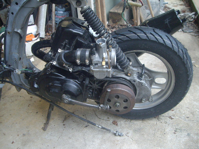

Done some limited work installing one on my 103 a few years back; ![](https://i.postimg.cc/gkyqXgM5/pumper-1.jpg) Got it going,but had the typical pumper problem of rich running after throttle roll off,can be cured with careful pop off pressure setup which I never did... Be a great drag carb though!!

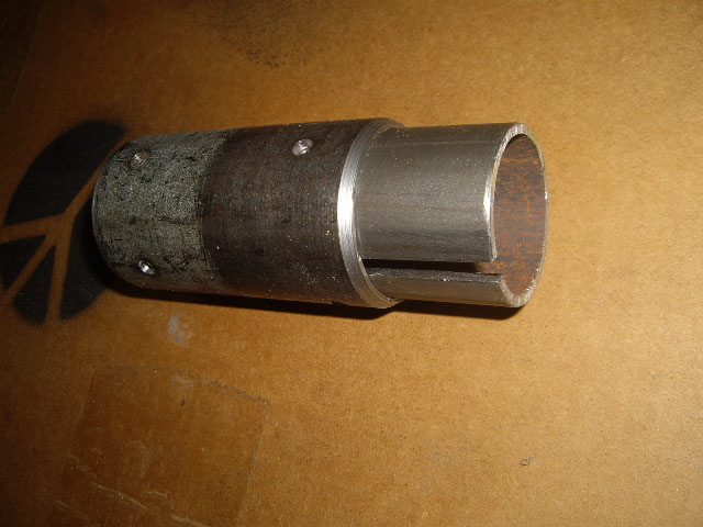

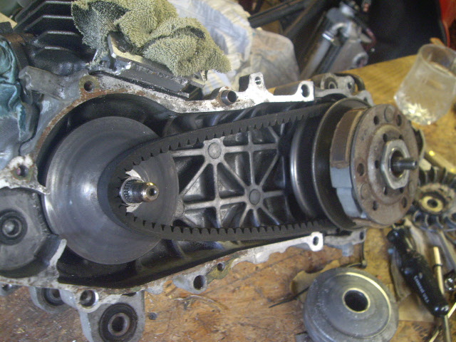

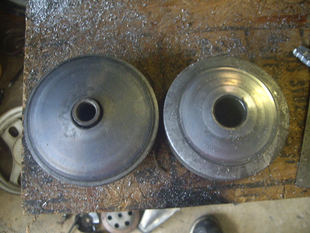

Thought if Ive been this long doing a Honda,why not do the Mina/Yam CVT swap..Found this guy on Youtube that did it,looks like a nice improvement..A few pics of the swap; ![](https://i.postimg.cc/d0bjKtGH/mina-dio-cvt-1.jpg) ![](https://i.postimg.cc/9QSGGFgm/mina-dio-cvt-2.jpg) Here is the how to link; www.youtube.com/watch?v=WO5-QguDjAQHe cut the Honda vari sleeve OD to match the Yam OD,,I went the other way,Yam sleeve ID(13mm) bored to Honda ID(14mm),soft metal so it cuts easy on the lathe.. ![:)](//storage.proboards.com/forum/images/smiley/smiley.png)

Thought if Ive been this long doing a Honda,why not do the Mina/Yam CVT swap..Found this guy on Youtube that did it,looks like a nice improvement..A few pics of the swap; ![](https://i.postimg.cc/d0bjKtGH/mina-dio-cvt-1.jpg) ![](https://i.postimg.cc/9QSGGFgm/mina-dio-cvt-2.jpg) Here is the how to link; www.youtube.com/watch?v=WO5-QguDjAQHe cut the Honda vari sleeve OD to match the Yam OD,,I went the other way,Yam sleeve ID(13mm) bored to Honda ID(14mm),soft metal so it cuts easy on the lathe.. ![:)](//storage.proboards.com/forum/images/smiley/smiley.png) Yeah that guy is pretty damn ingenious with how he makes things work with what he has

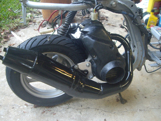

Moving at a snails pace due to work load and summer heat,its finally stuffed into the spindley Honda frame; ![](https://i.postimg.cc/g29WD8Jz/af16-mounted-1.jpg) ![](https://i.postimg.cc/Sst0zz3p/af16-mount-2.jpg) Hope to get is 'busted off'(southern term for starting an engine) real soon!
Post by Jwhood on Sept 3, 2019 18:09:07 GMT -5
I like how that exhaust turned out looks perfect can't wait to see it run

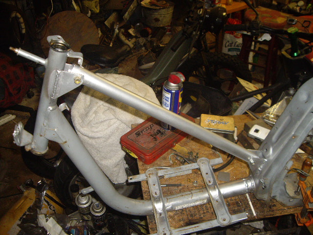

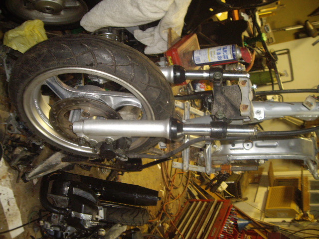

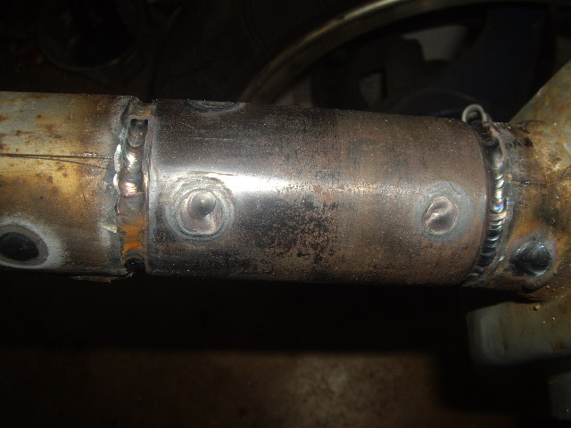

Still working on it!Darn thing is uncontrollable,,wheelies with the slightest throttle blip,when touches down front end wobbles trying to pitch the rider off...Looked at frame swaps,then figured keep the Elite frame and make it safe,,did a frame extend(3.25") on the main tube with some 4130 I had in the shop,added a frame brace as I could flex the frame by hand .030" at the head tube with little effort,,Then spliced a HEAVY Vento Zip disc brake 12" wheel front end that oldgeek gifted me a while back,dropped the tubes and kept full travel still fitting under the stock front plastic..A few pics of the progress; ![](https://i.postimg.cc/BQ8gxgkB/el-s-1.jpg) ![](https://i.postimg.cc/wM1hQqfj/el-s-2.jpg) ![](https://i.postimg.cc/Hs7wJL8S/el-s-3.jpg) ![](https://i.postimg.cc/266vCjf7/el-s-4.jpg) ![](https://i.postimg.cc/XJmghByC/el-s-5.jpg) Engine is back in,polishing the turd plastics,wiring 2 different harnesses together,will post as progress is made! ![:D](//storage.proboards.com/forum/images/smiley/grin.png)
