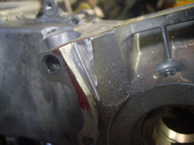

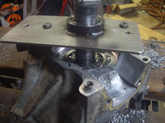

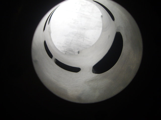

Old geek gifted me a pile of scoot parts a while back including a complete AF16 motor and a bunch of aftermarket parts(Thanks OG!!)..The AF16 is quite a different design from the Mina stuff Ive worked with,but thought it would be an interesting change,I liked the fact that longer stroke cranks could be had over the Mina's,so the provided Tiada 49.6mm stroke crank was the choice,a 50mm Tiada cylinder assy was ordered so it would be the ideal 'square bore/stroke'combination..Cut the cases to fit the bigger OD crank; ![](https://i.postimg.cc/D0wMFF98/af16-case-cut.jpg) Had to hack out a "C" port tunnel in the case for the bigger cyl; ![](https://i.postimg.cc/026VCtPR/af16-boost.jpg) The cylinder looked nice out of the box,but turned out to be a ton of work to get even close!OG said his 50mm cyl was miles off(he is right!),but he chose a longer 52.+mm stroke crank later and that made it waaay better..My cyl had the been cast with the transfers and exhaust crooked(core shift),had to deck 1.7mm off the deck to get the squish close,with the thick base gasket the transfers were the ideal 130 degrees,but had to cut 1.5mm off the transfer bottoms to match the piston dome at BDC..Ex dutation was a tiny 172 degrees and I wanted 190 degrees.. Had a heap to cut out,then found the casting was too thin above the ex port for that amount!I decided to try the Frits Overmars radiused port method; ![](https://i.postimg.cc/sDQvDW94/af16-td50-2.jpg) ![](https://i.postimg.cc/dVRQLj7r/af16-td-50-1.jpg) Had to make a sheet metal reed box to angle the reed toward the duct in a straight shot,used my favorite KX65 reed assy; ![](https://i.postimg.cc/4yz4V68D/af16-sm-intake1.jpg) ![](https://i.postimg.cc/SKJyDFT7/af16-sm-intake-2.jpg) ![](https://i.postimg.cc/Hn4HVpnH/af16-sm-intake-3.jpg) Thats it for now,will finish the reed box and move on to getting the cases finished..

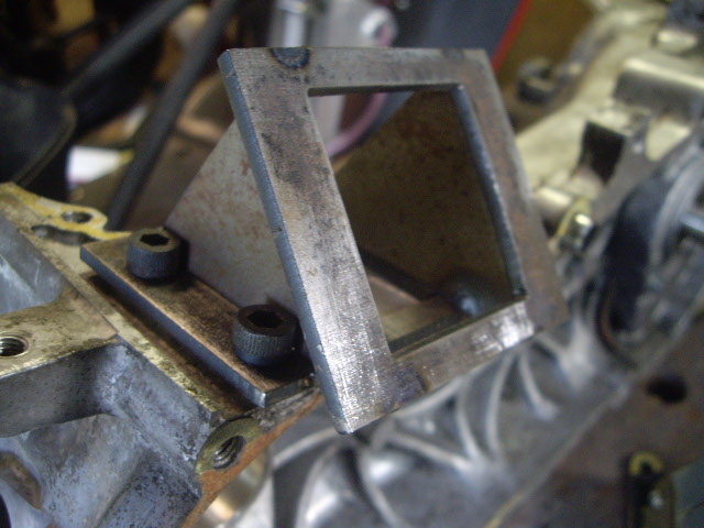

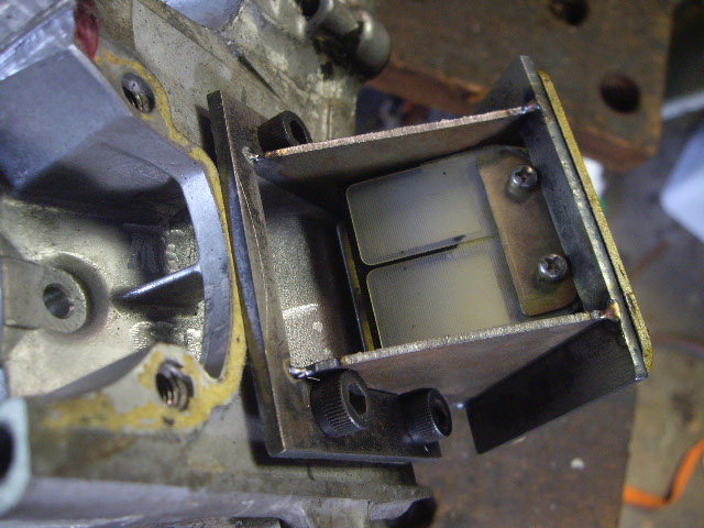

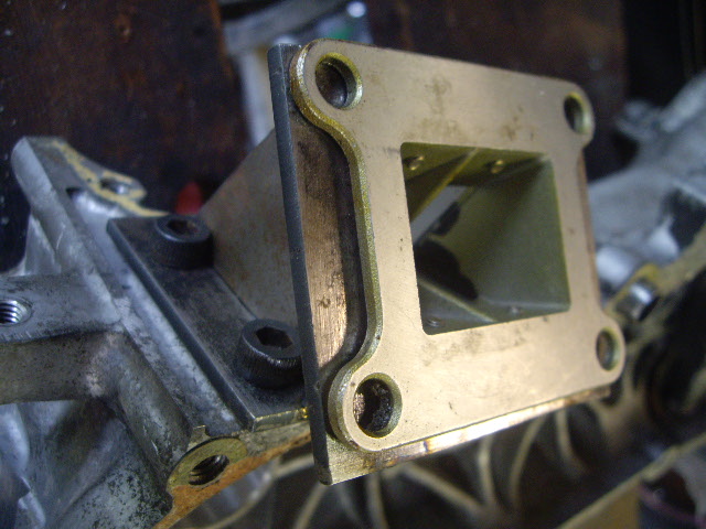

Had to make a sheet metal reed box to angle the reed toward the duct in a straight shot,used my favorite KX65 reed assy ![](https://i.postimg.cc/Hn4HVpnH/af16-sm-intake-3.jpg) Thats it for now,will finish the reed box and move on to getting the cases finished.. btw, you can get a CT 'big valve' manifold for dio (af18) to fit this motor and that kx65 reed block, but usually the casting is so far off that you have to grind out a bunch of the inside to fit an actual KX65 Reed block and you have to deck the mating surfaces to make it seal, and it comes with an almost 90° bend in the carb mount so it isn't a straight shot... Never mind, building one is a better option haha.
