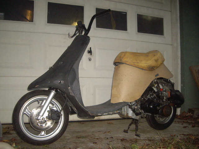

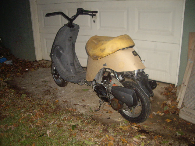

Post by 190mech on Nov 17, 2019 18:21:12 GMT -5
Started on prototype rear cowl buildup,what y'all think? ![](https://i.postimg.cc/L8Tcv6zF/sb50-aft-cowl-1.jpg) ![](https://i.postimg.cc/xjzBhPKR/sb50-aft-cowl-2.jpg) Yeah,got some more turd polishing to do yet but hopefully it'll "look good from the mailbox"!!
Post by oldgeek on Nov 17, 2019 20:30:08 GMT -5
Dang! That looks pretty good from here! Do you need a rear brake cable and lever? I just saw one in scootopia for an 94 Elite that should fit the bill.
Post by 190mech on Nov 17, 2019 23:35:44 GMT -5
Already have a cable and lever,it was in the pile of parts,,Thanks!
Post by harleyracer59 on Nov 18, 2019 0:32:04 GMT -5
I have a cable a lever/switches also, if you do need one. did you extend the motor mount yet? I would do that first before building the rear cowl if you haven't. would suck to put all that work in only to re-do it to fit again. with that said, looks good. your seat looks a little high. is that mounted on stock hinge and latch? your panel sorta looks like an af09 super tact panel... I wonder how one would fit on there. theyre shorter height wise and longer length wise than USDM second generation aero nb50. I have a set on my orange aero if you want to compare measurements. LMK. are you planning on fiber glassing over that for a finished product?
Post by 190mech on Nov 18, 2019 5:22:26 GMT -5
Harley,I dont intend to stretch the mount as I feel it is the weakest point in the frame structure,,making it longer can only increase the torsion on that area causing possible failure..Yeah,I know lots of folks do it but I'll build another frame before I go down that well beaten path..The final panels will be thin plastic sheet or possibly aluminum,,seat height is all stock..Will give a ride report when its all back together..

Post by harleyracer59 on Nov 18, 2019 22:30:29 GMT -5
Harley,I dont intend to stretch the mount as I feel it is the weakest point in the frame structure,,making it longer can only increase the torsion on that area causing possible failure..Yeah,I know lots of folks do it but I'll build another frame before I go down that well beaten path..The final panels will be thin plastic sheet or possibly aluminum,,seat height is all stock..Will give a ride report when its all back together.. I totally understand what youre saying. the frame mounting locations on them old Hondas frames were sub par to begin with. now double the hp... ok, so we wont stretch the engine mount, if you lengthened the floor board 3" you could move the seat forward 3" if you wanted to. you are building the engine covers. every inch you can move your weight forward of the rear wheel and closer to the ground, is a step towards better riding characteristics. just throwing out extra ideas for you to ponder on. I personally vote for aluminum panels. I think a polished set of hand formed aluminum panels would be bad ass.

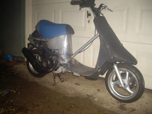

Post by 190mech on Feb 16, 2020 19:24:26 GMT -5
Been a while!Work load is heavier than ever,but have been pecking away at this project when time and weather permits..Got the rear cowling fabbed from an old lexan 1/16" experimental aircraft windshield(free and forms easily),Will paint it on the inside to get full 'experimental' effect..Oh yeah,did a few test rides after the frame stretch and Vento Zip front end install,niice and stable now!! ![](https://i.postimg.cc/K8sKg1BJ/AF16-lexan-skin-1.jpg)
