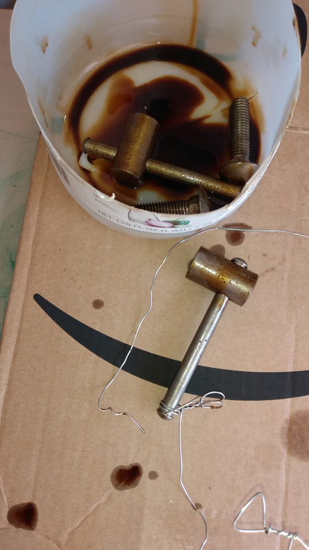

Post by jloi on Oct 14, 2020 4:44:14 GMT -5
well I heated everything in the oven at 410 degrees- for a fuckin hour - nada , no thing , zip . I think maybe the oil I got from the corner shop had synthetic mixed with regular oil and the process won't work with synthetic . that led me to watching more vids .
back to the drawing board .

Post by FrankenMech on Oct 14, 2020 10:57:56 GMT -5
I don't know if a black oxide process will work on zinc plated hardware.
Post by jloi on Oct 14, 2020 11:36:00 GMT -5
sure did . also , now I think the big spindle and 2 small t handles weren't ever chromed . in images of new vises the handles are so shiny it looks like chrome- but now I think it is just super highly polished steel. don't know if I should continue trying to find some non synth used oil or buy (more money ) some kind of bluing/blackening product .

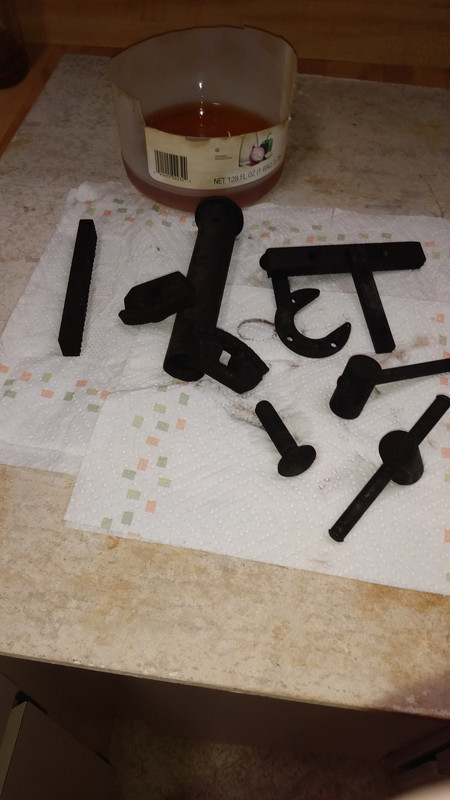

Post by jloi on Oct 14, 2020 11:51:40 GMT -5
FrankenMech- I suspect the only pieces that might be zinc plated are the new large bolts,nuts,washers from home depot. correct ??
this is everything I want to blacken
Post by jloi on Oct 14, 2020 12:27:28 GMT -5
Post by FrankenMech on Oct 14, 2020 13:07:44 GMT -5
The purchased bolts would be zinc electroplate. Zinc can be removed in a bath of muriatic acid.
Drain the oil out of the lawnmower, should be nice and black dino oil.

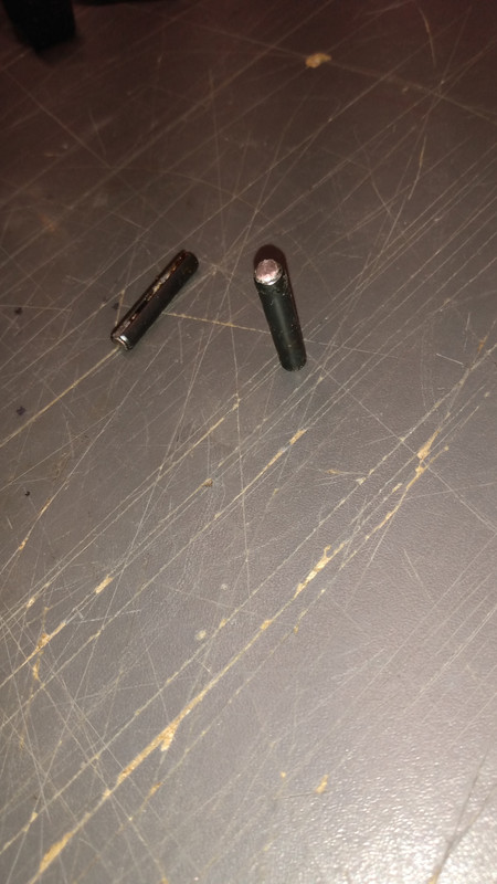

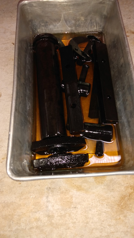

Post by jloi on Oct 15, 2020 19:22:31 GMT -5
Okay, it's done . I'll put it back together tomorrow. they're not shiny but they're sure black . stuck em in some 10w40 afterwards .     the new chinese roll pins are hollow; the old ones weren't , so I soldered up the ends so trash won't get in the barrel .
Post by FrankenMech on Oct 15, 2020 20:40:57 GMT -5
Nice work!
Post by jloi on Oct 15, 2020 21:37:25 GMT -5
thanks a lot man . different method but your idea . thanks

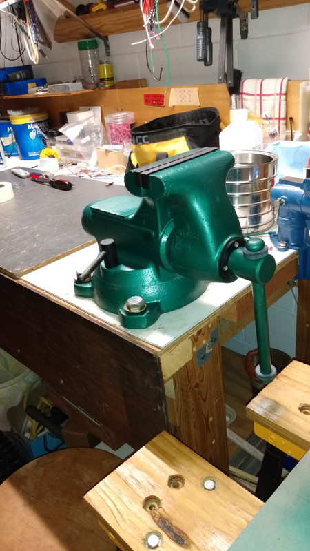

Post by jloi on Oct 16, 2020 1:08:43 GMT -5
well, I took the trash out and stopped on the way in . one thing led to another and it's all finished except the dust cover for the bullet end . the freeze plug will be here Monday . I hope it fits . I got a feeling the walls are gonna be too thick to fit comfortably .maybe U can grind them down if I need to .
Post by FrankenMech on Oct 16, 2020 6:01:45 GMT -5
That looks good!
