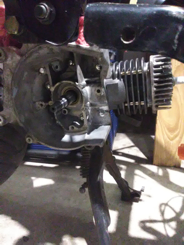

Post by Deleted on Jan 10, 2021 10:25:23 GMT -5

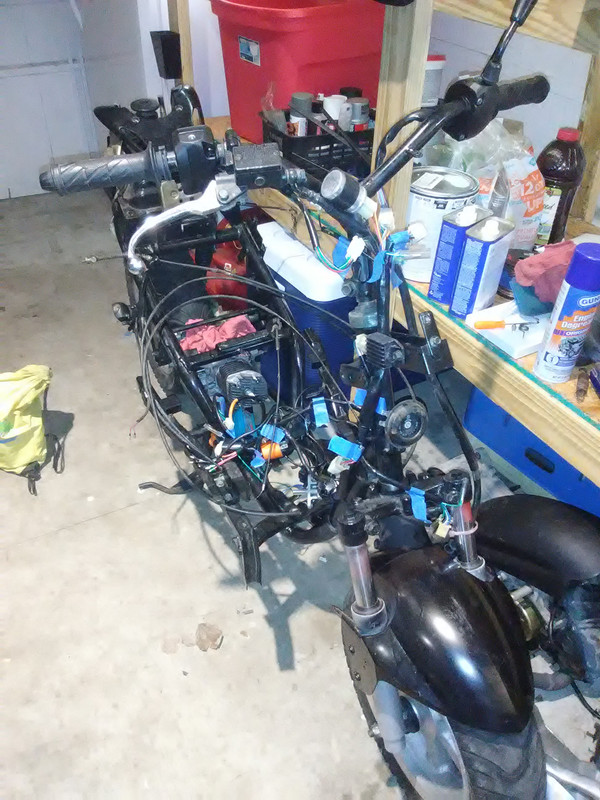

Alright! Naraku cylinder in place! Used the Adly head since it seemed to be much better quality than the Yamati that I had on hand. Compression is likely to be a bit higher, but should be alright. Also the scooter is back to being in one piece. Now I have to just make sure the electro lines up the way it's supposed to, and give the braking system a thorough checking. I know for a fact the back drum brakes are fine, but the front hydraulic system is suspect. Once all of that is in order, it's time to fire this girl up and see if she rolls.

Post by Deleted on Jan 11, 2021 15:31:41 GMT -5
I forgot to mention something that the finish on that Naraku cylinder was pretty rough. Always a good idea to check the ports. A lot of rough edges that could possibly snag a ring. Went after them with a round file. Didn't take hardly any effort to smooth out. Sure a lot of you all know about it, but just in case, I thought I would mention it.

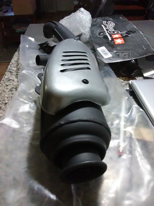

Post by Deleted on Jan 13, 2021 17:15:42 GMT -5
The pipe has arrived. I went with the Stage 6 Street Exhaust. Never worked with Stage 6 products, so I thought this would be an easy intro. Not a bad pipe per se. Has a few dings and scratches from sitting in the warehouse. A little bit of surface rust as well. Kinda heavy, but seems solidly built. The connector is a little weird, and I wasn't prepared for the 2 piece construction. Should be an interesting install with the Naraku cylinder. First I have to do battle with the restrictor. No obvious welds that I can see, so I'm gonna go with the big screw driver method.
Post by aeroxbud on Jan 13, 2021 19:06:17 GMT -5
Good luck. I think they only manufacture one universal exhaust. Then have a selection of adaptors to fit each application. Should be a good upgrade.

Post by Deleted on Jan 13, 2021 20:27:03 GMT -5
aeroxbud yeah we'll see how it goes. Unlike Yasuni, Stage 6 really tacks that restrictor in place. Couldn't really budge it with the driver. Rotary tool it is! Lol.

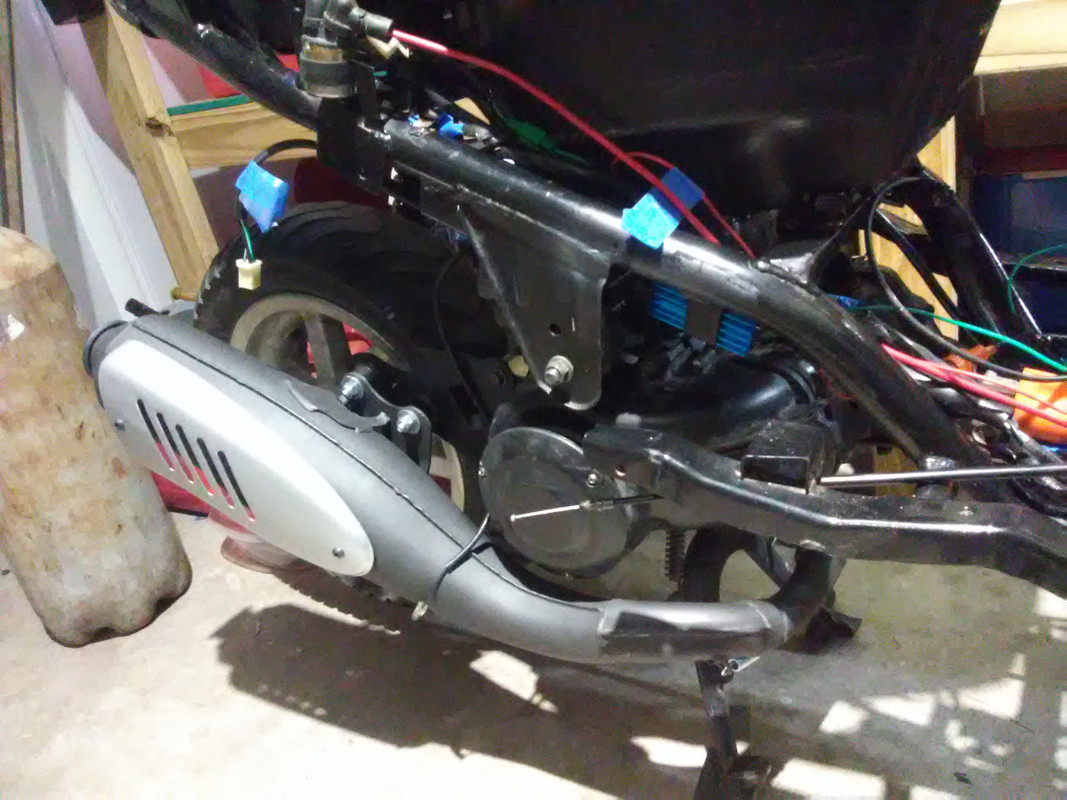

Post by Deleted on Jan 16, 2021 20:19:26 GMT -5

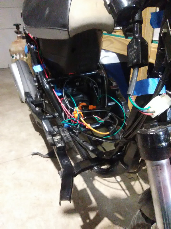

Pipe is on! I gotta say, the Stage 6 gave me a little trouble but it is.on there. Also got the electrical hooked up and cleaned up. Got just one set of connections to sort out tomorrow and the front brakes. Hitting that impatient phase where I wanna fire it.up, but gotta be patient and work steady. Short cuts lead to long delays, right?

Post by Deleted on Jan 24, 2021 20:02:39 GMT -5
It runs! Jetting needs to be adjusted. Definitely too rich from the smoke and sputtering, but it RUNS!
Pilot jet seems right on. She purrs like a kitten at idle. Had to make slight adjust to air screw. Currently at 1 and 3/4 turns. Idle was WAY too high. Turned it down and she ticks right along.
Needle is completely raised 5th notch. Might be able to drop to 4th notch, but I'm gonna fiddle with the main first. She sputters, spits and smokes at wide open. Gonna go down a size or two.
The electrical, on the other hand, is completely screwed up. Turn signals aren't quite working, nor is the brake light. Likely I have something crossed up. The wire colors on the new switches.dont quite match the old. I did manage to hook up the stator, coil, cdi, and kill switch correctly.
I'm gonna trouble shoot all that next weekend. For now, I'm gonna take the win. Hopefully I'll get the jets dialed in tomorrow and get a few test runs in down the alley and maybe around the block.

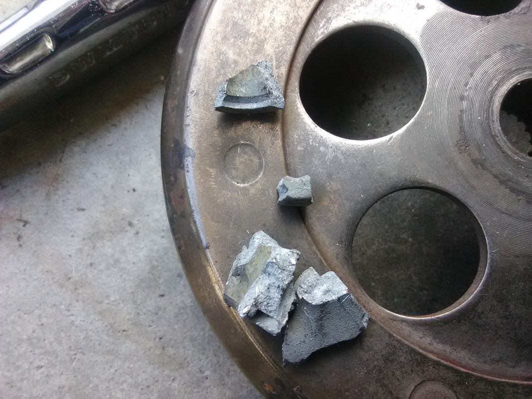

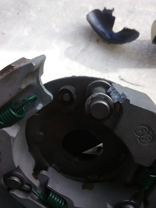

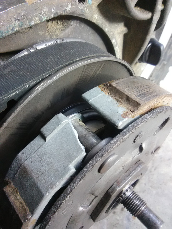

Post by Deleted on Jan 30, 2021 19:22:59 GMT -5
Oh man! We were going along so well. Busy week and I didn't have time to work on bike during the weekdays. Started in on it today. Got a lot of smoke and sputter, but it clears up here and there. Dropped the main to 82 and lowered the needle one clip. Some of the sputter went away but still there. Figured I would try a few more things with fuel system before I started eyeballing CDI and plug. Well, I never got that far. Suddenly engine starts rattling. I immediately hit kill switch. Go over the engine, nothing appears to be wrong. Fire it back up. No rattle. Working on the mix, notice back wheel won't stop turning. In fact it's spinning faster than it should. Hit the rear brake, can feel tension through the handle. Let go, wheel starts spinning. Do something really stupid and hand stop the wheel. Don't worry, didn't hurt myself. Can feel wheel trying to turn against my palm. Realize it's a transmission problem. Rattle comes back. Let go and hit the kill switch. Now I'm worried. Open up the cover. Variator is fine, belt is fine, but the clutch.... Broken clutch leaf aaaaand... a small pile of shrapnel. Well, we can't go any further now. New clutch pads on the way. Disappointment for sure, but it could have been waaaay worse. At least this happened during testing and not while on the road. That little pile of grapeshot could have done a number on the other transmission, seals or belt, but it didn't. Thank goodness I didn't bind up the wheel and mess up my gears. So, plenty to be thankful for, but still...
