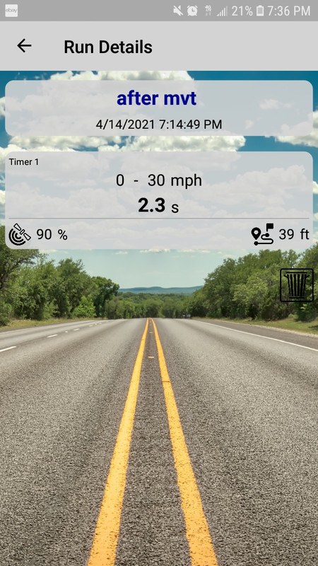

Post by x7rocks on Apr 14, 2021 20:46:53 GMT -5
Got a pwk 28 in the mail today from Amazon. Ran the engine around the block a few times but felt the 41 pilot jet was a bit rich. Lots of little sputtering going on. But a little ping i used to hear is gone. So that's a good benefit. Also got a 0-30 run with the mvt and the new carb. Was happy to see the number . But sadly the belt started to really wear out. So i placed an order for replacement one that stage 6 seems to have for their variator set. At size 775 it should work nicely. An the angle is just about right The engine part of this build is kinda at an end. All that's left is a stroker crank (51mm or 52 depending on which one needs more crank work) And some up gears. But before all of that im going to see what the factory gears can do. The last idea i can think of that would benefit the engine besides the crank would be case work, and maybe a retrofitted kt100 exhaust if i can find one cheap enough and someone brave enough to weld it

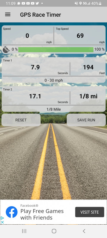

Post by x7rocks on Oct 16, 2021 10:20:34 GMT -5
Lol "nice," Ran out of fuel as well when doing this run but she gets to the 60s quick! Hottest temp achieved was 88.9c so it may be getting hot but darn. I thought dual radiators would keep things cooler but I do have to consider Florida heat and humidity. But during cruising Temps are around 75c to 78c so that's not so bad. 70 is a hair away and I know it:)
