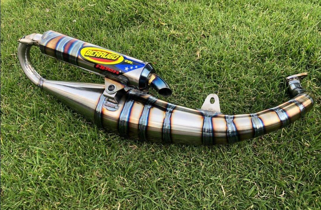

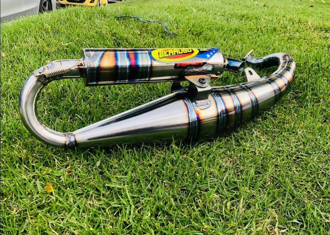

On a more positive note besides little pilot jet woes. I got shipping confirmation after the exhaust had some finishing touches done to it. I present the beruggo 117cc to 128cc exhaust. Made in Columbia
