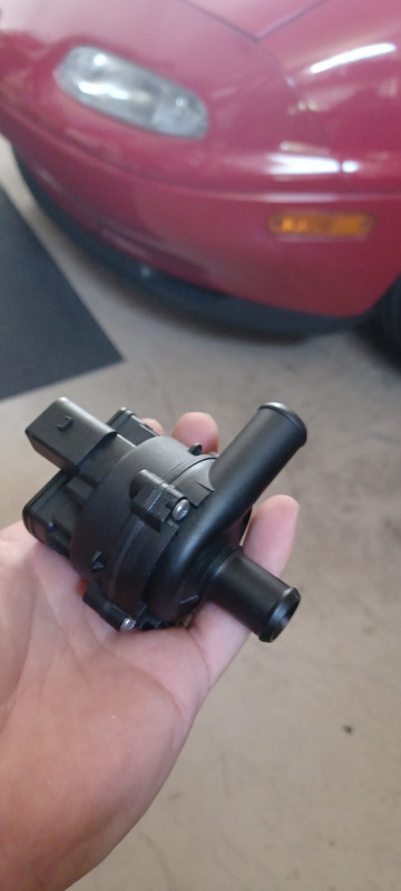

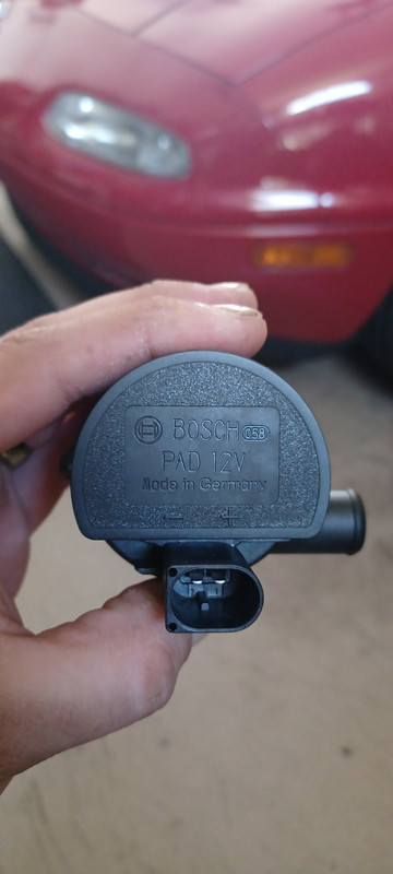

So I scooped up this stage6 waterpump for 160 usd. Lol jk. Found it on Amazon for 59 dollars shipped with next day delivery. From what I understand the flow is much higher so I'm hoping it keeps the engine cooler since it now revs at a higher rpm. But here's a pic to show how tiny this thing is.

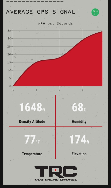

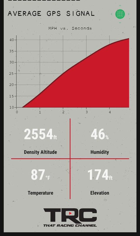

Also it seems I still could work on some very small dead spots in my acceleration. 6.8 weights with 11 gram malossi weights. Vs the 3x 6.8 and 3x 7.0 gram weights
So maybe a smidge lighter weights. Maybe throw in some more 6.8 gram rollers and adjust the clutch to higher launch settings (haven't done this yet as I really wanted to get the vario weights done first)

Got another video to share with you guys  gonna give the Bosch waterpump a shot today when the pig tail connection arrives. youtu.be/QvdGUCFcTBgI actually want to ask a question. Should I have the flow go from radiator to the head or draw from the head to the radiator like I have it now? I ask if it would make a difference as it would be easier to prime the radiator system if the pump sucked from the primary radiator and flow outward from the head rather than going into the head as it was previously set up. Any thoughts?
