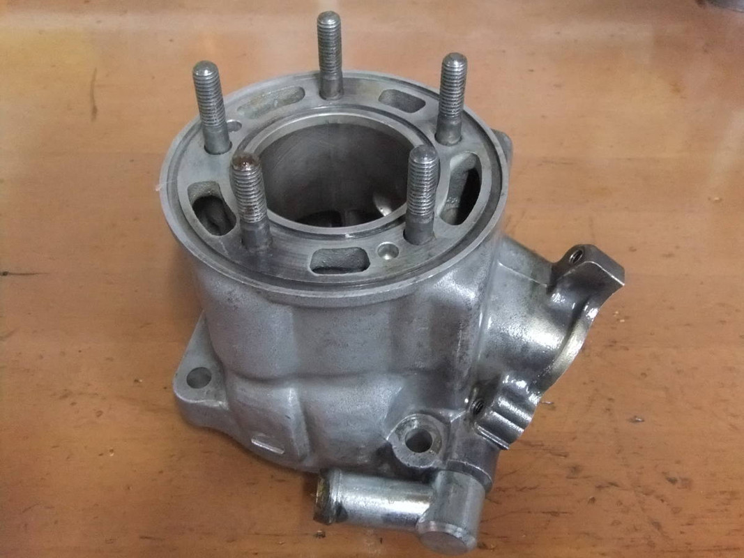

So. I guess this is where my daily tuner friendly 117cc gets thrown out the window into territory that's uhm... gonna be different than anything I've done before. I'm definitely going to need the communities aid in this as I really only have one shot to get a 54mm crankshaft and the cylinder to mount on the engine.

Ive got a BWS 100 52mm crank and the rod is cut waay down to clear the added stroke,bet a 54 is real thin..Which cylinder is that one?? A Honda rs125 nf4 cylinder. The stroke and wrist pin will share the same measurements as the honda top end, the crank also will come with the appropriate spacer. It kinda looks like an rt base for the 4vp aerox/bws cases

Ive got a BWS 100 52mm crank and the rod is cut waay down to clear the added stroke,bet a 54 is real thin..Which cylinder is that one?? A Honda rs125 nf4 cylinder. Ooof! You're aiming at 40hp?

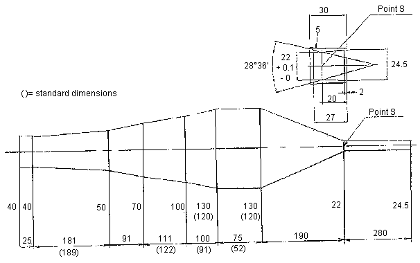

A Honda rs125 nf4 cylinder. Ooof! You're aiming at 40hp? I'm not entirely sure what to aim for as I am on roads that I've never been on so to speak 😅 I am curious on which measurement of the exhaust will give me the best output for the engine, I was able to find this on a website from Google that had timing information that made the 125 make its most power so I think a different cdi for the mvt will be needed? So much planning needing to be made 🤕

You could buy a used pipe from a mx125 bike, make it fit for the time being and go from there? Yeah unless you have build specs for a RS125 pipe from the beginning. Maybe combine those with specs from a nsr125, cagiva mito 125, tzr125 or any of the Jim Lomas and Jolly moto dimensions that circle the internet.

You could buy a used pipe from a mx125 bike, make it fit for the time being and go from there? Yeah unless you have build specs for a RS125 pipe from the beginning. Maybe combine those with specs from a nsr125, cagiva mito 125, tzr125 or any of the Jim Lomas and Jolly moto dimensions that circle the internet. That's a fantastic idea, I spoke with William over a video call. An he says the pipe being made will be no issue so along as measurements are correct he will make mounts easy for me to adjust as the main thing he will need to compensate for is the angle of the exhaust and to mount it properly on the engine. Jollymoto is definitely a pipe style I'd love to run and he will more than likely replicate it to a T. Now I just need to research dimensions like you stated. Thank you for the info man it's greatly appreciated
