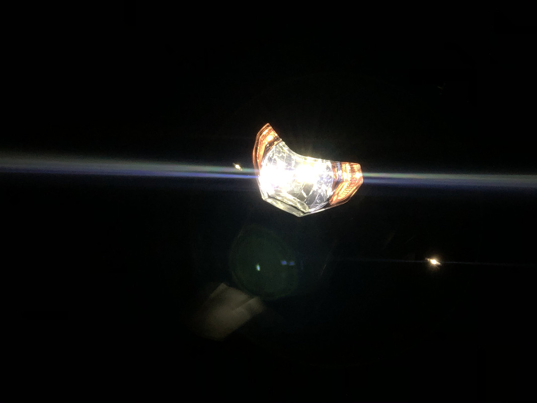

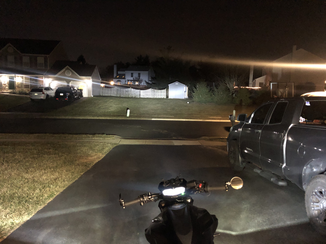

I picked up a few more things... some shorty levers, a cyclops 10.0 led head lamp and my springs are due here tomorrow. The led is incredible it turns night into day. In the picture below the 2 running lamps beside the headlight were the same color as the headlight, now they look amber...They are getting replaced also. After I pick up some fork oil I’ll tackle the springs. Last on the list is rearsets then I’ll call it done, maybe... Actually I’d like to reflash the ECU to get rid of the fuel cut on decel that causes massive engine braking and lower the fan on/off temperature lower.

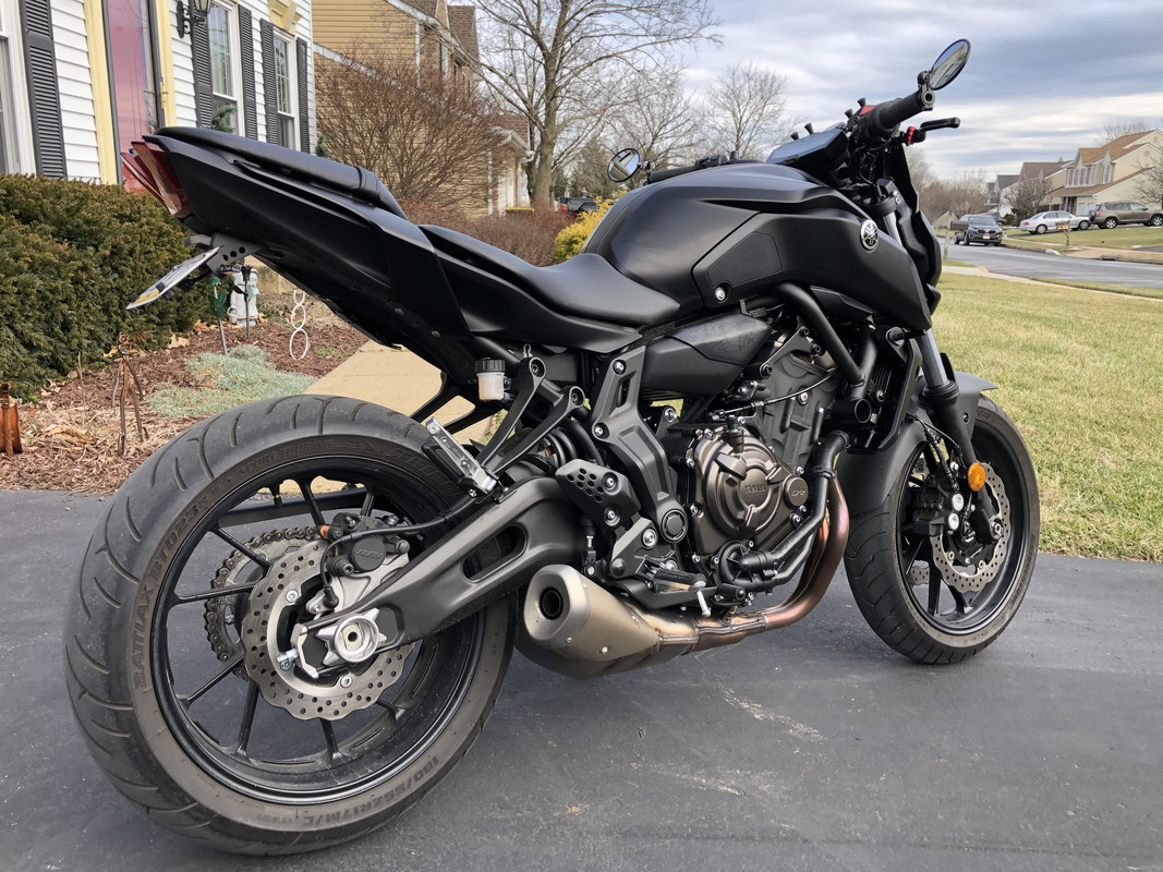

Suspension is done and it feels like a complete different bike. I went with racetech .95kg springs, preload adjusters and 15wt oil. There is virtually no nose diving on braking or coming off the throttle, well not like it was. From my research these are originally setup for 130-140 riders not my American size. I’ll have to wait for the salt to get washed away before I try my twisties but I have a feeling they will be more enjoyable. I took the time to setup the static sag and preload where racetech recommendation was. It was a few different spacers to be cut but it’ll be worth it. The rear has some adjustments so it may be fine as is. I think the Zuma is calling for some fresh oil and some new learned suspension tech.

So I did get a chance to get on the back roads to try out the suspension and it’s a night and day difference. The on/off throttle isn’t as much of a change in the suspension as it was, the turn in on the corners feels much more secure then before and I feel I can lay into the corners and not have to worry about upsetting the suspension. Really this was a much needed upgrade and will be well worth the little bit of time to swap springs.
