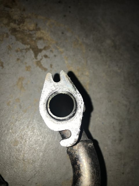

Post by captincvmn on Dec 31, 2020 15:11:42 GMT -5
Giannelli flange. Admittedly easy to put on. I did clamp a 3/8” nut to the flange as a drill guide and off center the holes both counter clockwise facing the flange face. (Fffff) I removed maybe 1/8” of material in that direction allowing the pipe to rotate clockwise looking down at the center of the scoot. This picture is pre-drilling. After looks very much the same.

Ok so the holes in the exhaust port aren’t quite the same from the Naraku to the Stage6. I’m gonna have to rework my exhaust/fender mount. Could you do like we do with the V8 canister exhausts on the Chinarelli's, use longer bolts and use some old rollers as spacers.
Post by captincvmn on Jan 3, 2021 22:57:14 GMT -5
