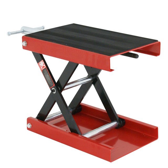

Post by chadbullet on Jul 1, 2021 9:02:53 GMT -5
I use a stand like this for working on my prebug without a center stand. It's quick to go up or down. I'll use it underneath the frame in front of the engine.
