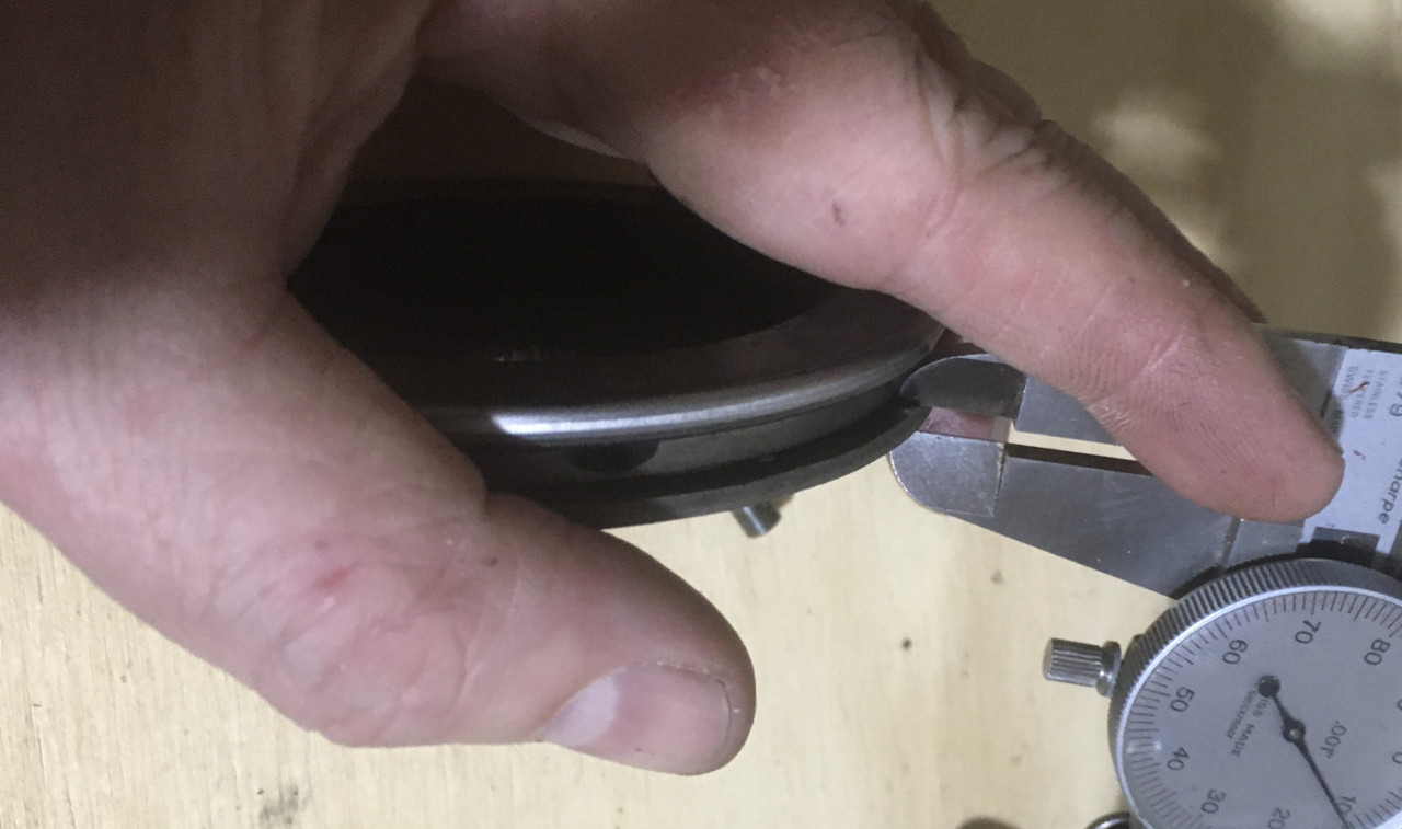

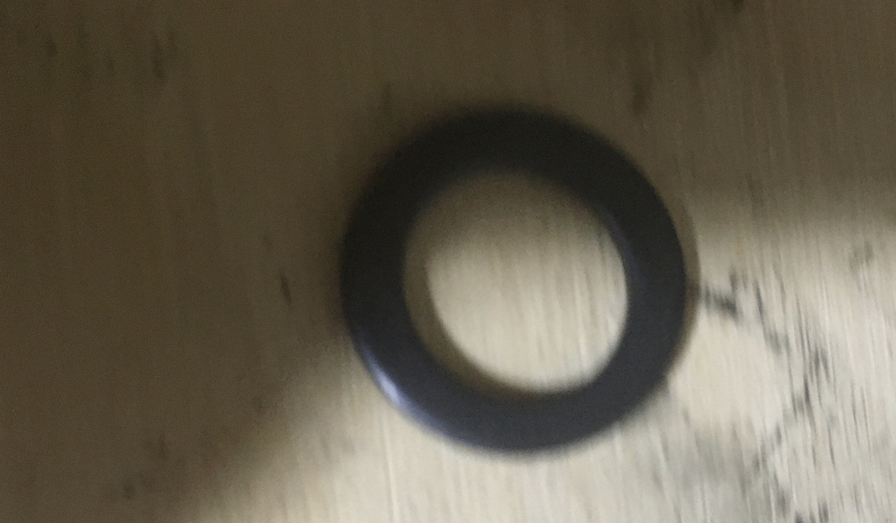

here is my starter delete Electric starter delete I did this a couple weeks back The engine spins up a little faster with the extra weight off the crank . So I did find I am running 6 grams on the variator for the same shift point E-start 5.5 grams was 9100 rpms when I hit the throttle 6 grams was 8800 rpms After Delete 5.5 grams hit 9400 rpms and 6 grams hit 9200 rpms I did have to shim it for taking out Starter clutch I used the Malossi shim that came with the variator on the backside where the starter clutch was I used 2.5 mm total 2.5 to 3 mm would have worked you could use a 1/2 inch washer from a hardware store to space it out . I just measured the starter clutch like this ![](https://i.postimg.cc/9Xq8D1X1/IMG-1074.jpg) the malossi shim ![](https://i.postimg.cc/SsYrzN4j/IMG-1077.jpg)
