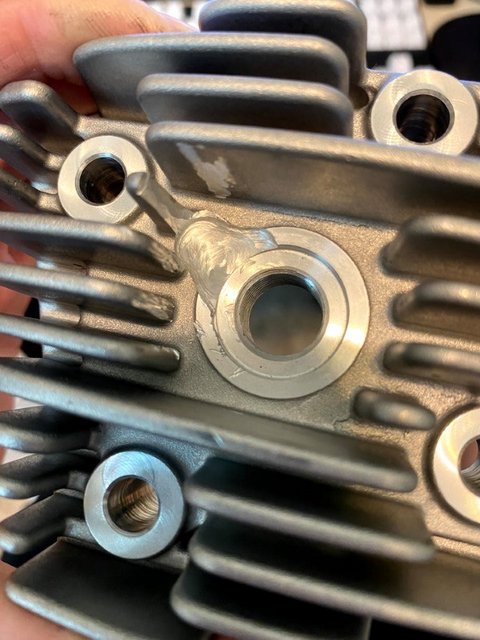

So it looks like the Trailtech spark plug temp sensor won’t mount on the Stage 6 MKII Sport Pro cylinder. The spark plug hole is recessed for the plug and squish ring and that prevents the spark plug from fully seating with the sensor installed.
I’d love to find a way to install a temp sensor. Would love that added insurance. Eapecially with the aluminum cylinder.

Ok. I found out I need to grind a recess for the temp sensor. I can do that.

Post by chadbullet on Jul 4, 2021 9:13:00 GMT -5
So it looks like the Trailtech spark plug temp sensor won’t mount on the Stage 6 MKII Sport Pro cylinder. The spark plug hole is recessed for the plug and squish ring and that prevents the spark plug from fully seating with the sensor installed. I’d love to find a way to install a temp sensor. Would love that added insurance. Eapecially with the aluminum cylinder. Most people dremel the head to make clearance for the sensor. I saw a post about it on a facebook group I'm on a few weeks ago. I'm trying to find the post so I can show you how it looks. edit: I see you already figured this out 2nd edit: found the pic!
